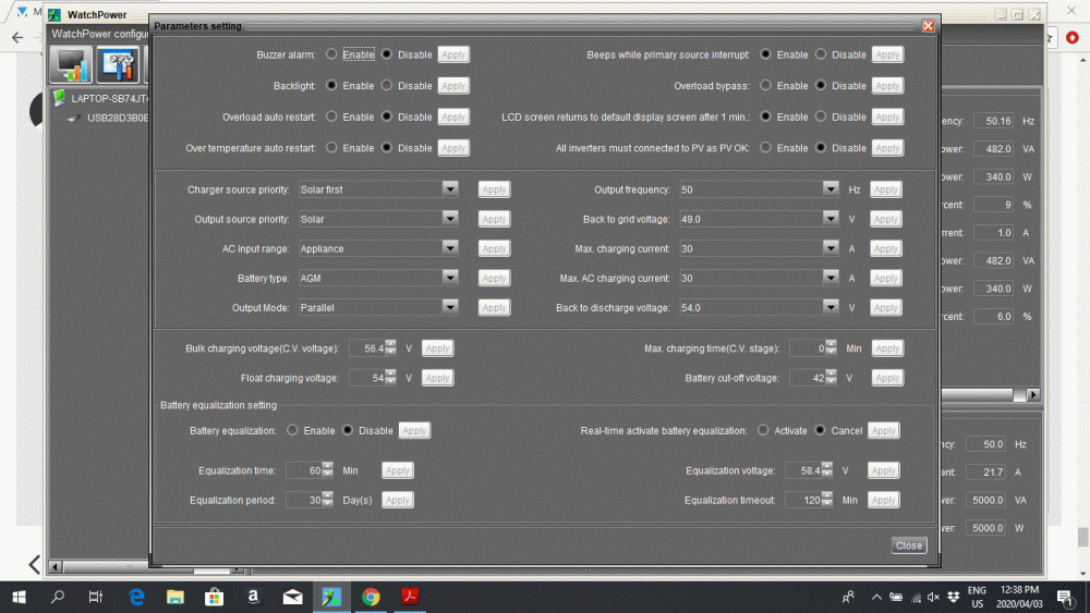

Chris Louw Posted May 23, 2018 Share Posted May 23, 2018 Hi everyone . Does some one have experience of Axpert 5kva/5000watt with 4000 watt mppt , firmware 74 - 20. Setting 32 Bulk charging time option (1) inverter to judge option (2) 5 to 900 min . Setting 33 Battery equalisation. (1) Equalise. (2) Disable Setting 34 Equalise voltage 58.5v - 64 v Setting 35 Equalise time default 60 min or 5 - 900 min Setting 36 Equalise time out default 120 min or 5 - 900 min Setting 37 Equalisation interval default 30 days or 0 -90 days Setting 38 Neutral to ground setting Setting 39 Equalisation activated immediately I Realise the settings are dependent of the battery type . Does anybody have any experience if settings are reliable . Quote Link to comment Share on other sites More sharing options...
Chris Hobson Posted May 23, 2018 Share Posted May 23, 2018 Just remember you should not need to equalise VRLA batteries. If you do you need to be aware that you will lose some electrolyte which cannot be replaced. Quote Link to comment Share on other sites More sharing options...
Chris Louw Posted May 23, 2018 Share Posted May 23, 2018 I have a Royals batterybank on another inverter 3kva that cannot reach equalising charge . If this inverter can do a good charge it will help a lot Quote Link to comment Share on other sites More sharing options...
