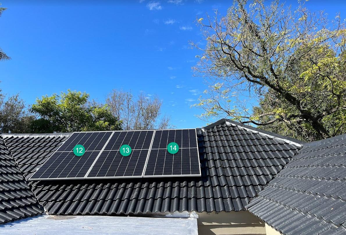

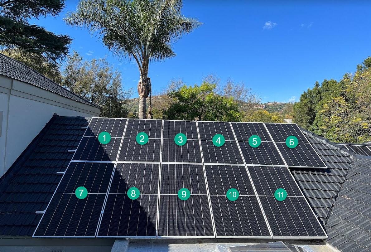

In order to help just the following.
1.   Are all panels facing the same direction. It appears to be the case.
2.   Is there space for a panel either side of 15 and 16.
3.   Is there space for 1 panel to the right of 14.
4.   The shade is it in the morning or afternoon.
Thanks again Scorp007 for your response!
I have responded in bold below:
1.   Are all panels facing the same direction. It appears to be the case.  Yes, that is correct
2.   Is there space for a panel either side of 15 and 16. Yes
3.   Is there space for 1 panel to the right of 14. Yes
4.   The shade is it in the morning or afternoon. Morning
I have also researched using this website and created the attached spreadsheet. If I have done this correctly and understand the theory, I'm already at my maximum panel amount, but I should be OK to split the 8-panel array into two sets of 4 each. I would value your input on the attached spreadsheet.
How Many Solar Panels Can I String Into My Inverter_.xlsx
How Many Solar Panels Can I String Into My Inverter_.xlsx 458.89 kB · 0 downloads
Thanks for all the detail. You are very far off the max the way I see it. You can go up to 12.8kw in panels. There are 4 x MPPTs to connect panels to and 8 is the maximum. If we reduce this to 7 then one can get to 28 panels.
But then the but leaves us with 12.8kw as the maximum so we can go to 23 panels.
The last step will be to see what is the best fit to reduce a whole string being affected by shade.
I will look into this in the morning and give my 2c..
Edit:
In order to reduce the effect of shading would mean quite a bit of re-stringing but here goes.
M1 and 2 are MPPTs on inverter 1. M3 and M4 on inverter 2.
Option 1.
Early morning one string of 4 will have low production but not affecting the other 4.
M1-1 2 7 8  M2-3 4 5 6
M3-9 10 11 15
M4-12 13 14 16.
Option 2.
This entails moving 1, 7 and 8.
This use 15 panels so one can see if any of the 4 panel strings can accept the 16th panel.
1 and 7 either side of 15 and 16. Also 8 to the right of 14.
Thus we have M1-3 4 5 6 9 10 11
M2-1 7 15 16
M3-12 13 14 8
Let's see what other members suggest.
