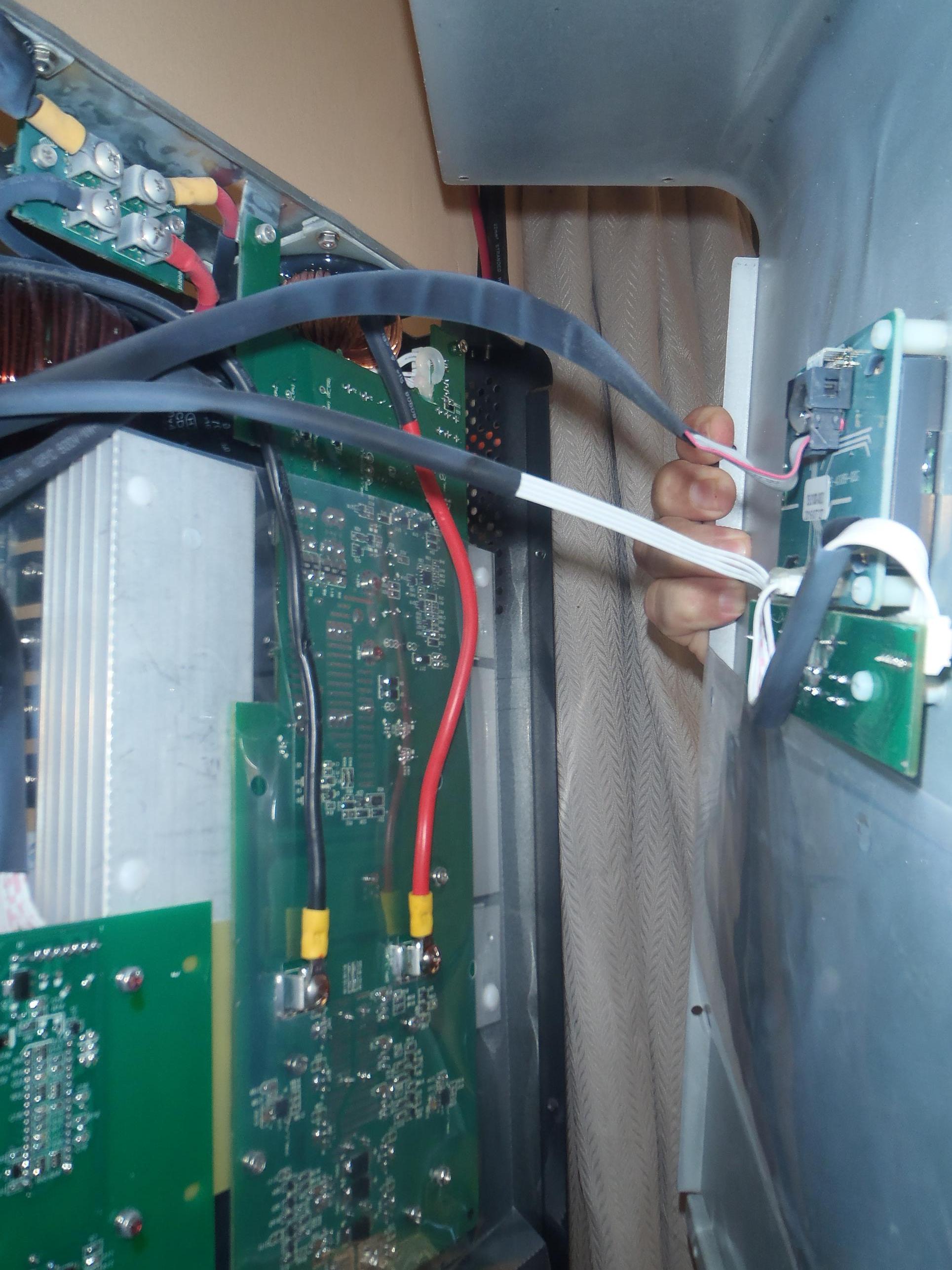

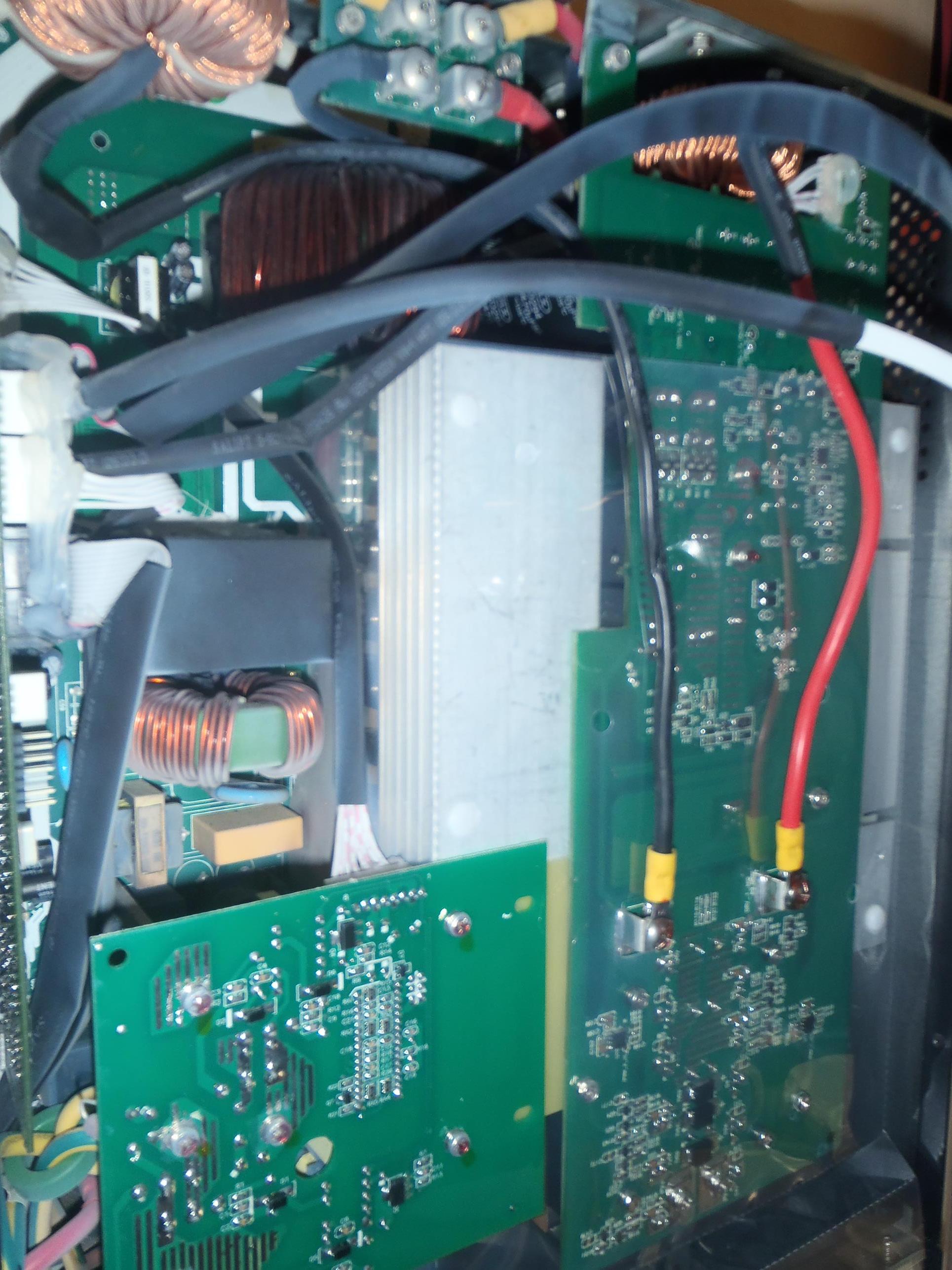

flltech Posted March 21, 2017 Share Posted March 21, 2017 Interestingly one of the system that I saw today for repairs has the U1 firmware as 32.40 but that is the PWM model - Axpert KS 5kVA-48V. Since you have no "manufacturer date" sticker on any of the screws, you could remove the front cover carefully and click a photo and send it here. We can confirm whether that is PWM or MPPT model. Other possibility I see is that it is not a real Voltronic product and probably one of the copied inverters. Mark and Chris Hobson 2 Quote Link to comment Share on other sites More sharing options...
Chris Hobson Posted March 21, 2017 Share Posted March 21, 2017 Having looked at your photo is it a dual MPPT version? Quote Link to comment Share on other sites More sharing options...
flltech Posted March 21, 2017 Share Posted March 21, 2017 Here is sample sticker of 5kVA MPPT 80A model. Even the AC input/output currents do not match. Either it is highly customzied model or it is not form Voltronic. Quote Link to comment Share on other sites More sharing options...
stuvo Posted March 21, 2017 Share Posted March 21, 2017 @Coulomb I only have a 200ah bank so I've got my max charge set to 20A. Anyway @flltech here are some (poor) pictures of the interior. Quote Link to comment Share on other sites More sharing options...
flltech Posted March 21, 2017 Share Posted March 21, 2017 Ok design looks like an MPPT model. So no worries there. The only difference I can point out right now is all the screws look different than those in other inverters I have seen. I think best to wait till your supplier gets back to you. stuvo 1 Quote Link to comment Share on other sites More sharing options...
