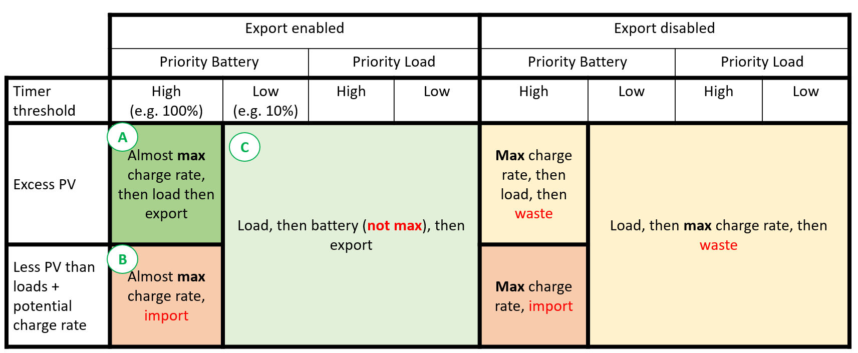

Hi again. I have tested all the combinations in scenarios when there is either an excess of available PV or less PV than loads and possible battery charge rate
In all scenarios, the maximum battery charge rate is only achieved when export is disabled.
With export enabled, the closest you can get to the maximum battery charge rate is when you set Priority Battery and have the Timer limit at a higher SOC than your present SOC (e.g. set it at 100%) (A). When there is excess PV, you get almost max battery, then load, then export. As SOC increases (~>50%), the battery charge rate drops off more from the charge rate you would get with export disabled.
untitled image

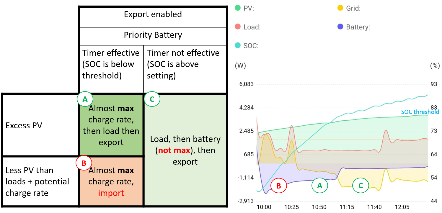

If it's possible to predict when you will definitely have excess PV and set the timer threshold accordingly, then the closest compromise you can get is (A) and then (C). The risk is (B) when there is low sun, then you get priority battery and import instead of load then battery.
The following sample shows those three modes (where the timer threshold is 80%), assuming export enabled. In all cases battery charge rate would also have been higher if export disabled.
untitled image
untitled image
In summary, I find: in all scenarios, enabling export means that the possible battery charge rate will not be maximised. There is no combination of settings that prioritise load, then max charge rate to battery, then export. Aside from when Priority Battery, and below the Timer Threshold, they will prioritise load, then split battery and export with a logic algorithm that is not clear. I suspect its a simple case of paralleling them with no prioritising. Unless someone can help me find a solution, I would suggest this is surely something that Sunsynk could improve.
