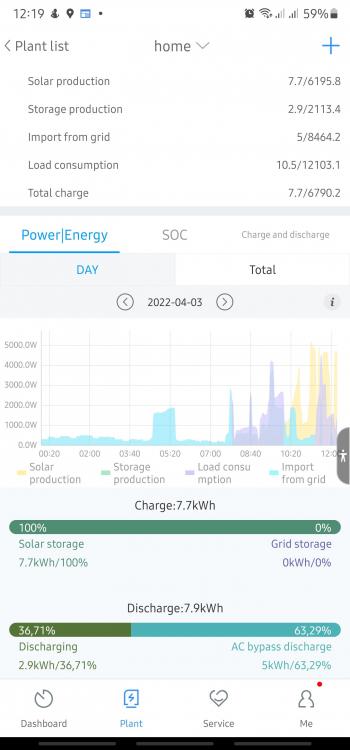

Buyeye Posted April 3, 2022 Posted April 3, 2022 (edited) Hi @Leonb I have a severon 5kw heat pump outside with the geyser in the ceiling and pipes insulated. I've set it to heat up water for morning showers before I get up. It seems to use quite closer to specs according to the inverter stats. Here are 2 screen shots. Temperature outside when it came on was between 16 and 18 degrees celcius. It does use slightly more electricity when it pushes the water to 58 celcius. What Temperature do you have it set to? I'm sure 60 degrees celcius will use more electricity. Edited April 3, 2022 by Buyeye Quote

Bobster. Posted April 4, 2022 Posted April 4, 2022 21 hours ago, Buyeye said: I've set it to heat up water for morning showers before I get up. It seems to use quite closer to specs according to the inverter stats. Here are 2 screen shots. Temperature outside when it came on was between 16 and 18 degrees celcius. It does use slightly more electricity when it pushes the water to 58 celcius. What Temperature do you have it set to? I'm sure 60 degrees celcius will use more electricity. Try going downwards. As long as you have to use the cold water tap when you're taking a shower you are over heating. This is a subjective matter. What some folks call a good hot shower puts me in fear of blistering. It will obviously take more power to heat to higher temperatures, but what is the RIGHT temperature is a personal preference. Quote
