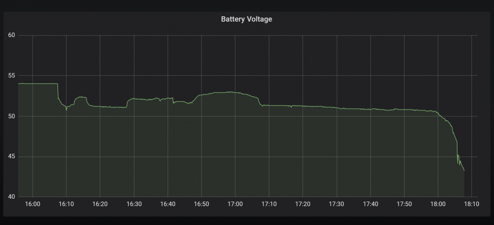

Ben Harper Posted April 14, 2022 Posted April 14, 2022 I've recently upgraded from a 3 kW Axpert VMIII to a 5.6 kW MKS 4. I have 4x 100Ah AGM batteries, which previously ran at 24V, but now I've got them all in series for 48V. I've had them for 2 years. For the first time ever, my system cut out today (after 2 hours of load shedding), because the battery voltage dropped below the cutoff of 42V. What I find really strange, is that my total battery power draw for this session was only about 500 Wh (due to a bit of solar still available). Also very peculiar, is how my battery voltage drops without warning from 50.8 to 40. Power draw is fairly low throughout this period, and the period when the battery starts to drop is not under abnormal load. It's about 350W all the way. Does this mean my AGM batteries are dying? I've had them for 2 years, and have treated them very well. I try to keep them under 30% DOD. Or could it be that it's my new inverter that's doing something wrong? My setup is: 5.6kW Kodak MKS4 (3 weeks old) 8 x 355W solar (2 years old) 4 x 100Ah AGM batteries (2 years old) Quote
Beat Posted April 15, 2022 Posted April 15, 2022 13 hours ago, Ben Harper said: Does this mean my AGM batteries are dying? I've had them for 2 years, and have treated them very well. I try to keep them under 30% DOD. Or could it be that it's my new inverter that's doing something wrong? I'm afraid your AGM batteries are getting old. Also 100Ah is rather low for 5.6kW inverter. Why not going Lithium? Quote
Coulomb Posted April 15, 2022 Posted April 15, 2022 14 hours ago, Ben Harper said: Does this mean my AGM batteries are dying? I've had them for 2 years It depends on how well they were charged. I see they start (in the graph you showed) at about 53 V, that's about 13.25 V per 12 V module. That seems slightly low for a float voltage, so it's possible that the bulk/absorb setting is a bit low too. There is also the premature float bug, proudly featured in even the newest Voltronic models. This can undercharge the battery, and chronic under-charging can truncate lead acid life to about 2 years. So what are your battery settings (bulk/absorb and float settings mainly)? Quote

Coulomb Posted April 16, 2022 Posted April 16, 2022 (edited) 2 hours ago, Ben Harper said: When the sun goes [ shines ], it stays at the bulk voltage (56.4) for only about 10 minutes. After load shedding, it stays there for quite a while (eg 1 hour). IF you're only using the battery for load shedding, that makes some sense. When there is no load shedding, the battery stays nearly full; you only have to replace storage drain and some losses. So the battery quickly gets to the absorb (bulk) voltage, and doesn't need much absorbing until it's full and the charge current falls below a threshold and float stage starts. After some load shedding, the battery takes time to even get to the absorb voltage, since there is significant charge to replace. It stays at the absorb voltage for an hour or so before it's full enough that the charge current falls below that threshold. So it doesn't sound like YOU are affected by the premature float bug, at least for most of the time. Edit: Which means sadly that the battery appears to be getting a full charge, which then points to the battery having lost capacity. You could attempt some equalisation charging, which risks losing water forever, but if they are going to get replaced anyway, it might be worth a shot. Start with short equalisation periods (e.g. 10 minutes), and not too high a voltage (e.g. 57.6 V), then ramp up the time and/or voltage to see if they last any longer before reaching that voltage cliff. Edited April 16, 2022 by Coulomb Quote
