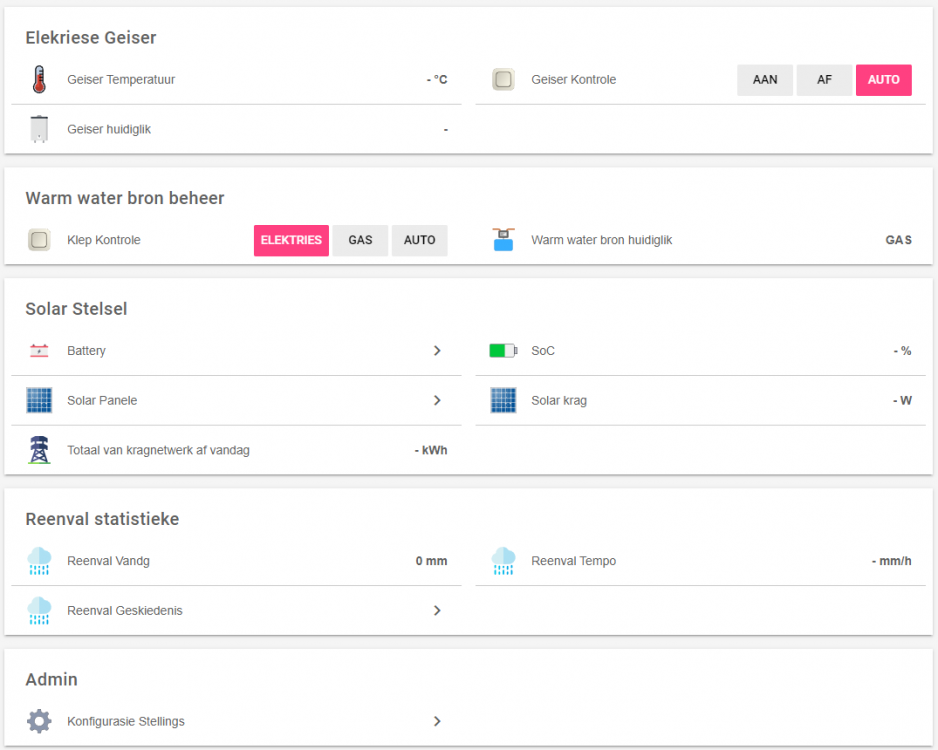

October 7, 20223 yr @Supergeek woops, my bad. Sorry, completely missed your question. In my case I didn't get too fancy (not my system). The metrics from the inverter are basically just used to control a geyser automation system. My father-in-law basically runs off-grid, so I use battery % and PV yield to dump excess energy into their electric geyser during the day and also ensure that the electric geyser doesn't deplete the batteries when there's limited PV available. And then I also display some basic stats via openhab (no graphing, father-in-law is happy with the info from the luxpower app, plus I'm not sure the Pi zero would be happy with running grafana or similar). For the rest of the system I monitor the electric geyser temp (DS18B20 + Tasmotized Sonoff TH16 with a retrofitted 2kW geyser element, keeping the original thermostat in place), which then determines the hot water source between the electric geyser and gas geyser via an electrically actuated 3 way valve (+ another Tasmotized Sonoff and a SPDT relay) and some configurable temperature thresholds in the OH app/interface. Quite a basic little setup, but it works nicely 🙃 Not very flashy, but this is the basic (OH) interface (this is just the template on my machine, so no values, as I'm too lazy to try log into the OH account at the moment) - the rain stats are shared from my system via a cloud MQTT broker - the older you get, the more you care about rainfall stats 😆 (they're hijacked from an Oregon Scientific kit using an RTL Software Defined Radio setup and pulled into my system): I might do something similar (water source control) in my system once I (finally) get done installing the gas geyser.

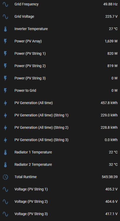

June 20, 20233 yr On 2023/06/19 at 11:39 AM, WantToGoSolar said: Hi there Zombie, I am interested in SolarAssistant and Homeassistant.... Did you investigate any further? I have one Pi4b, was thinking of starting with HA seeing it's free. I am running HA on a VM on my laptop while I play around with it (I do have a pi waiting for it). I've successfully gotten the HA>MQTT>lxpbridge>SNA 5k inverter communication chain going ; now it's just diving into and understanding yaml. Below is what lxpbridge exposes. Would love to see what solarassistant gives.
