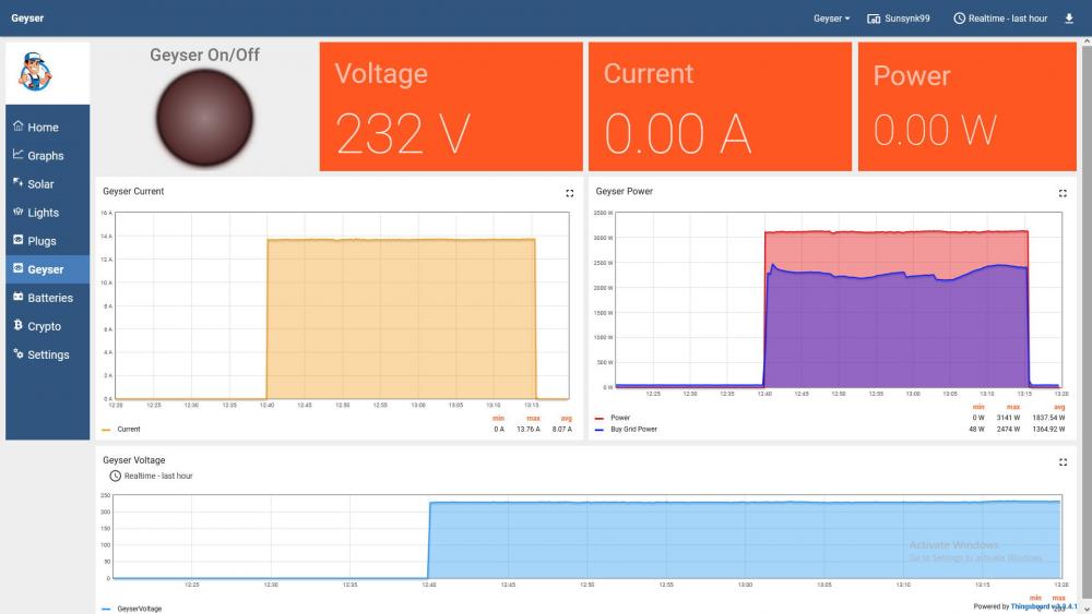

Its mostly about conversion efficiencies that most people overlook when planning/designing their system.
Mostly the installer will take care of the brainy working out stuff, but if you do DIY like I do then you should factor this in.
Battery DC watts do not directly match/correspond/convert/invert to AC watts.
There are all sorts of efficiency losses across the system.
Cables/wiring/circuitry/temperatures/conversions etc have/add some losses/in-efficiencies, the inverter itself also gobbles up some 30-50 watts.
You can see this on the image below.
Battery is providing 369 watts at 7.44 amps into the inverter, some of it is used to power the inverter and rest is pushed out to the ac loads.
So here the AC loads are using 277 watts at 1,2 amps
sunsynk-battery-usage-stage3-loadshedding-small-crypto-farm.thumb.jpg.d459c763cb0c2e201d7330c567f8e87a.jpg

The image/dashboard I show is not the sunsynk screen, that's my own custom screen that gets the data from the sunsynk inverter.
I will drop an few images of the actual inverter screen and the sunsynk portal and link their data to my dashboards data for you to see the correlation between them.
Exactly what program did you use to create this, it’s fantastic, gives you everything you need to know all my n the same picture
https://powerforum.co.za/topic/12146-sunsynk55-simple-local-data-monitoring-no-cloudinternet-needed-setup-guide-step-1-the-software/
https://powerforum.co.za/topic/12185-sunsynk55-simple-local-data-monitoring-no-cloudinternet-needed-setup-guide-step-2-dashboardnodered/

11 minutes ago, WannabeSolarSparky said:
Awesome stuff, thank you.
Thank you

6 minutes ago, WannabeSolarSparky said:
The official Sunsynk Data Portal/app
I prefer my own as I can do it how I prefer :)
I won’t lie, I prefer yours to!

On 2022/05/22 at 12:29 PM, WannabeSolarSparky said:
10x 540watt Jasolar split 5xEast 5xWest, nice even spread of power throughout the day, production a bit lower during winter due to east west orientation.
@WannabeSolarSparkyhow much power do you generate on your best and worst day from the 10 panels?
My whole house excluding the stove runs off the inverter 24/7, geyser is on an automated sonoff tasmota switch to only run in the afternoon after the batteries get to 100% soc. I must add that it is just my wife and I, and we do not use a lot of power.
With regards to the sonoff. Does your geyser run on your essential side of the inverter and then you have set a time on the sonoff switch to allow power through once your batteries are charged. But if you don’t have enough solar power then the geyser will eat into your batteries supply?
im asking because this is abit confusing. Do you have to monitor your solar production constantly in order to switch on your geyser? And your stove doesn’t run on solar at anytime regardless if you have enough solar power.
I thought that your stove and everything would run on solar during the day and then when there isn’t enough solar it would draw from the power supply.
basically I’m worried about eating into my batteries with the geyser if there isn’t enough solar. I can’t quite find the answers on exactly how the sunsynk inverter works.
regardless I’ve already bought the 8kw inverter, will arrive next week due to stock. And at this point I’m leaning towards 4x pylontech us3000c but still haven’t made up my mind and I’m also struggling to figure out how many solar panels I need. I’ve been at this for weeks and all this information is mind blowing,
