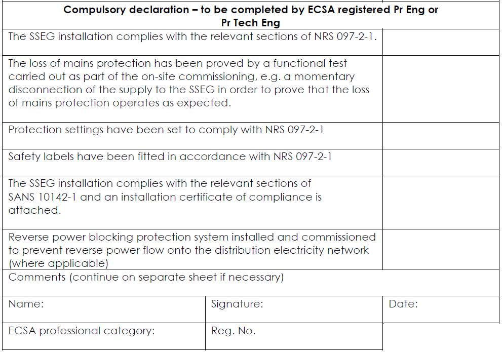

This topic actually makes me think. If we have a Victron Multiplus installed as a UPS for the office, is it legal? (gut feeling says yes, it must be). If I then add an MPPT and some solar panels, in what way does that change things? The danger (if there is such a thing) of accidentally energising the line in reverse is the same with or without the solar backup, in fact, you can use these inverters without PV panels to do "peak shaving" when they are configured as hybrid (by default they are not).
Do I now need an official PrEng or similar to sign off that it was commissioned as a UPS and that we cannot and will not feed back? Because it sounds to me like that is what might be needed if they want to be consistent about this. There has to be a clear distinction between embedded generators and UPSes. Well... I already thought there was... but I digress.

I have looked SMA via a approved installer and the regs are pretty straight forward to meet and to get approved. Easy as Pie.
Getting the inverter certified is a costly exercise, definitely not straight-forward. If you have such an inverter (or the Ziehl as I do), then it is indeed simply enough to do the paper work. 6 things on the list, all of them NRS097-2-1 stuff. They really just want to know that this thing is not going to push back.
The trouble is finding a PrEng that's not going to cost the earth. Rumour has it that a plan is being worked on to make this part simpler. It also depends on what Nersa decides.
Here is a snapshot of the bit you need.sseg.jpg.c51b42900a90df2ae25712acca3776cb.jpg
