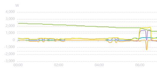

Preventing a Goodwe ES from using the grid.
Here's part of today's data from the Goodwe portal. Note how although load (yellow line) is light in the wee hours, it still uses some grid power (orange line).
Between 2 and 4 this morning we had load shedding, so the orange line goes flat, but everything keeps on running.
So, in the interests of squeezing the last drop of savings out of my system, is it possible to use the economic mode to force the system into using only battery from, say midnight until 5 am? The load is pretty constant and constantly low.
Eco mode might work, but I would advise against it. To me it looks like you are going below 150W at some points, and your inverter is designed so that below 150W, it disables the battery because the inverter itself will then be self-consuming a significant % of that 150W. So the best solution is to switch on a couple of things so that you are above 150W through the night - outside lights are always a good candidate.

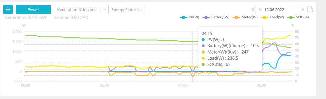

Well I ran the outside lights last night. Most of them are activated by photo cells, which is just as well, because the timer isn't working (it's the type with a dial that should be turned by the 50Hz, but it doesn't advance). This added a huge 50W to the load. Hard to know how much difference it made because we had load shedding from midnight until 02:30. But after about 2:30 we see the draw from grid again. So maybe a bit more is needed.
At 4:15 the load is 236.5 W and the system is drawing 247 from grid, despite their being plenty of battery. From 2:20 to 2:45 is is drawing a steady 180W. But SEMS is coarse data. Samples every 5 minutes
