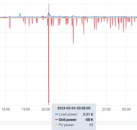

I just dont understand how they can put out critical firmware with so many bugs. According to solar assistant my inverters just sent an 88KW spike back to the grid except grid-tie is disabled. Be aware that if you install the same firmware you might see similar issues.
