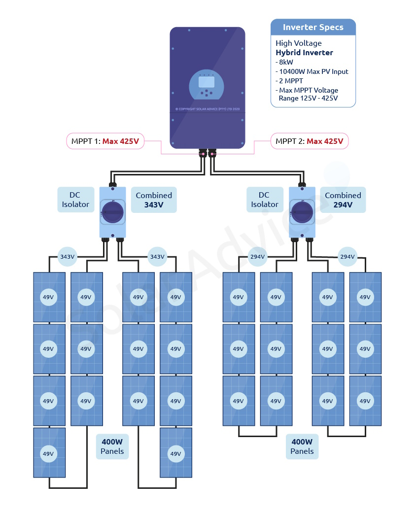

January 13, 20232 yr See case study 3 at Solar Advice: https://solar.co.za/how-to-size-a-pv-array#cs3
January 14, 20232 yr 10 hours ago, mzezman said: Pretty much, the current is clipped if it exceeds the MPPT but voltage will cause the MPPT to get damaged It is due to this reason and looking at the NOCT values that I would think in the link on sizing in the post from @system32 one can in fact use 7x4=28.Â
