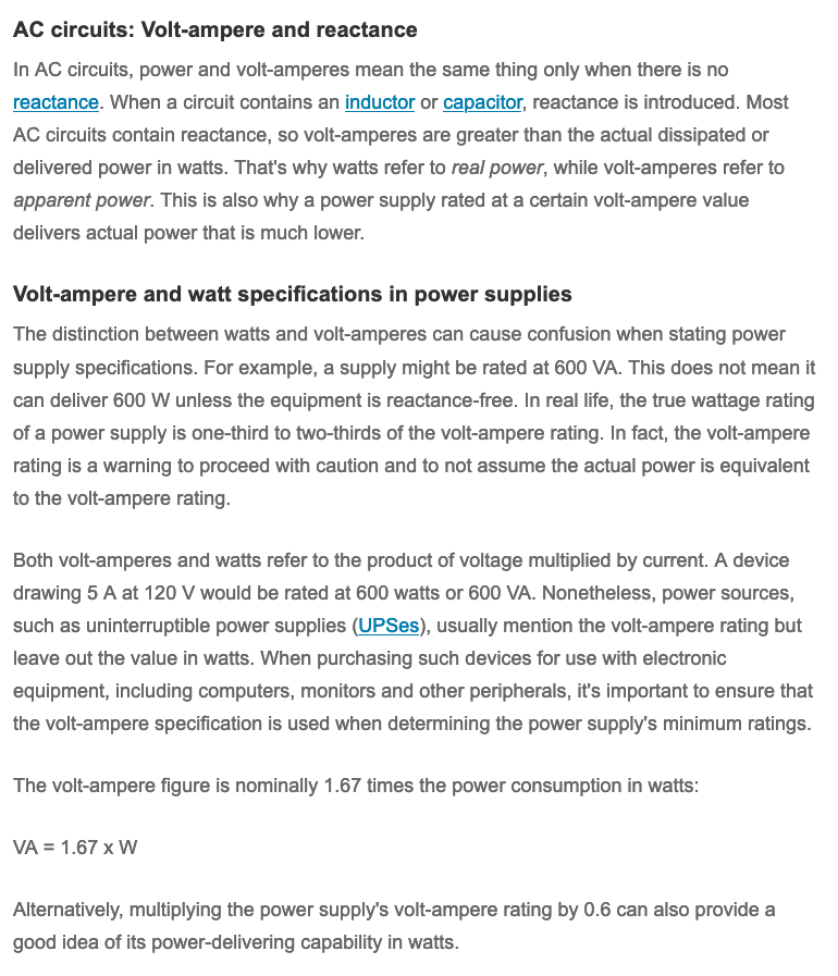

should be 24W absolute worst case scenario, but I doubt it, probably won't be more than 10W, I'd think... hey wadda ya know, I scribbled this before reading your complete posting and I just see you're also giving the 10W theory a 👍 we could both be wrong, though, I don't think by a heck of a lot...
the 160VA is supposed to be taking power factor into account on this page the following appears...
2039493090_Screenshot2023-01-31at20_04_05.thumb.png.b1dcc7abb51d72336f211912cc301f72.png
and thus you real wattage may be significantly less than the 160VA, ideal would be using a clamp on ampere meter on one of the battery leads, actually, I think you have two batteries, then you'd have to clamp both positive cables or both negative cables, going to the two batteries to determine the current draw and that times the Voltage, probably 13V is a safe-ish number to use for this back of the napkin calculation, but you can also measure it, should give you the W provided by the battery for the load in question...
