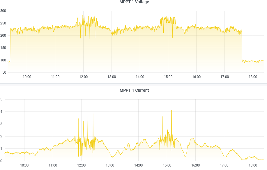

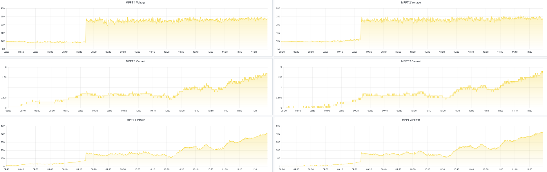

I can confirm that
90V stuck not fixed for me with very cloudy weather (first picture)
The firmware seems to act weird in light cloudy weither, maybe more reactive with voltage, to resume it's strange but no so much more power (second picture)
