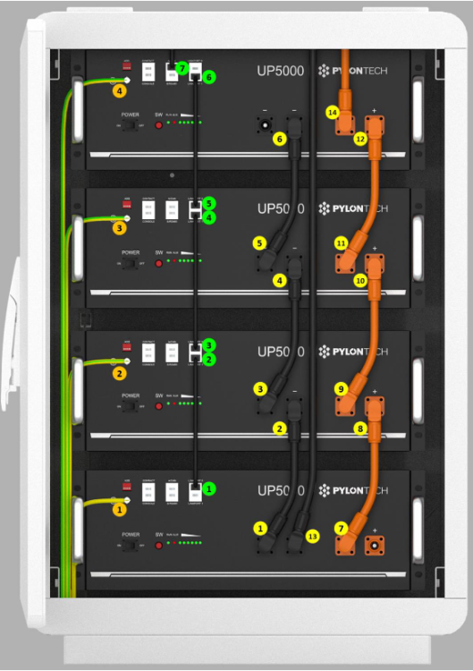

  • - 2 * 2000mm power cables (4 AWG, peak current capacity 120A, constant 100A) and communication cable for each energy storage system
The 2 banks of 4 wiring digram you have is incorrect. on the 1st of 4 batteries positive connected to Busbar and on 4th battery negative to Busbar, not both positive and negative to busbars on battery 1 and 4.
However besides for the connections being incorrect 4 x batteries at 100amp each 400amps per set of 4 or Peak 15s 800amp discharge will melt your cables instantly :0
Also the US5000 Max continuous charge is 100amp per battery, the Cables from the battery to the busbar are "rated" as per the manual at 100amp continous or 120amp peak.
So stricktly speaking you should have  set of cables per battery. When pairing the batteries in sets of 2 and using one set of cables you are potentially sitting with a Cable rating of 100amps continous and the batteries (2 of)  being able to supply 200amps continous.  Its a good recipe for a potential fire :) Also seen comments that even thought the pylontech cable sets are rated at 100amps folks have noted from 60 amps upwards they start getting warm, and people seemed to have concerns that the 100amp continous rating is a bit optimistic??

Have a look at the PylotechUS5000 manual page 18 onwards, none of the battery diagrams are wired like the proposed 2 by 4.
https://www.google.com/url?sa=t&rct=j&q=&esrc=s&source=web&cd=&cad=rja&uact=8&ved=2ahUKEwip_MyNlNf9AhVOY8AKHaI1A6AQFnoECAsQAQ&url=https%3A%2F%2Fwww.teci.co.za%2Fwp%2Fwp-content%2Fuploads%2F2021%2F02%2FUP5000-V1.0-Product-Manual.pdf&usg=AOvVaw3jG5P_j-9SjJZRRyrnIREo
in terms of the power cables. It's always + or - on the first battery to the Busbar, and also one + or - from the last battery to the busbar. So drawing power across the packs + on first pack to - on last battery. And the BMS worries about the Balancing of the packs, and the cells within each pack.
Your diagram for the 2 by 4, shows both positive and negative on the first and last packs being connected.  Also the 2 x + and 2 x - terminals on each battery pack have a common busbar which they are connected to behind the faceplate on the battery.
In the diagram for the 2 by 4, it would appear one is pushing and or pulling power from both ends of the combined pack? makes no sense?
I cant see a benefit, two positive cables on the first battery and two negative cables on the last battery will have double the current capacity? 200 amps?
However the interconnecting cables, (4 and 10) between the packs,  can still only carry 100amp, so why?  It just makes no sense?
Check with your pylontech dealer what their reasoning is??

@AlaskanNoob There is another option, run another set of cables from the open port on the packs fig 6 & 7 in the diagram.
They will need to be separately fused but you will double the amperage to 200A that you can draw from the packs without having to go to busbars.
I was educated about this option a few months ago on the forum 🙂
