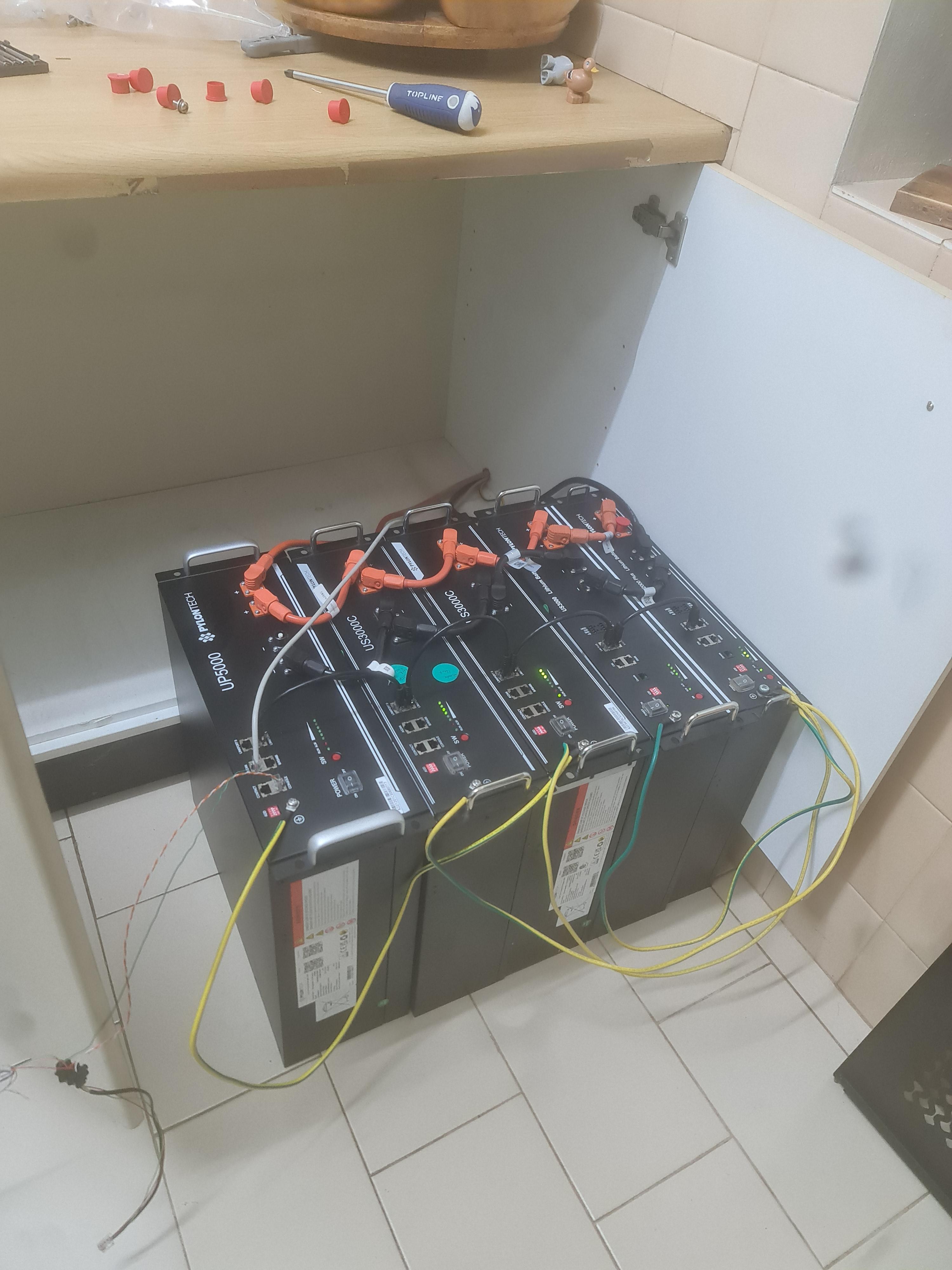

My Goodwe runs my UP5000 mixed together with 3000 and 3000C and 2000Plus', basically a mix and match of Pylons collected over the years, NO PROBLEM!
Telling the inverter what battery you have literally just sets an additional level of charge / discharge and DOD limits over and above BMS comms (at least I don't see any other advantage to setting the exact same battery type in Goodwe settings, maybe someone can correct me on this?).
I.o.w. what @P1000 mentioned is correct, a single UP5000 has the same charge / discharge current limits as two US2000 (doesn't matter normal or C).
If, for example, you have a UP5000 (50A max) mixed with a single US3000 (37A max) giving you a combined max 87A charge/discharge, set the Goodwe to 3x US2000, thereby setting max 75A; slighly lower but helps with the longevity of your batteries 😉

1 hour ago, FixAMess said:
Did you have to upgrade us3000a/b to talk to the up5000?
Not sure what you mean by upgrade - I did install latest firmware in all batteries, UP5000 as master, and off it went....
At the peak I was running (in this order):
UP5000 master
US3000C
US3000C
US3000
US2000Plus
(Temp install for only a week, hence the "incorrect" single inverter power cable...two of the batteries have since gone to my parents;-)
Edited by markus_m2
