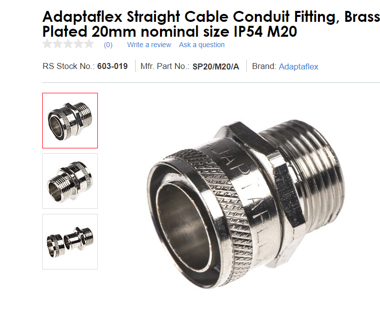

@Chris Hobson, a silly question if I may, but does anyone know how to terminate flexible conduit against a 25mm cable gland? I assume the Axperts in this picture doesn't have such a cable gland where the cables enter, so you might now know... but right now I want to know. I've seen it done.
Share this post
Link to post
Share on other sites
chief of staff
Posted (edited)
Havent done that , but used the gland specifically designed  for that.
I personally like the second one more. There is also an insulated one if you use the plastic covered spraque .
The supplier of the conduit should have the adapters/couplings in stock.
Edited by Jaco de Jongh

Commodore 64
Okay, so I'll swing past there again tomorrow :-)

Posted (edited)
OK, this morning I got two of the compression stainless steel ones, and two plain old plastic 25mm ones. I prefer the plastic ones because they look like the original ones on the inverter, and I don't like the metal-on-metal tightening required with the stainless ones. Thankfully it worked. I took my pocket knife and carefully carved out a bit of the lip on the cap so the flexible conduit fits, and tightened it down. Works perfectly.
Now the next thing I wonder about is these Merson MULTIBLOC fuse holders. The ends are not open, it is as if the cable is supposed to go in below the plastic shroud that sits over it. In the past I simply cut it off so I could get access, but in @Chris Hobson's pictures above it seems he  managed to keep it and attach even more flexible conduit to it. How?
Edit: Oh never mind, seems you are supposed to cut them.
Edited by plonkster
Share this post
Link to post
chief of staff
Posted (edited)
Sorry about that, it wasnt clear to me what flexible conduit you were referring to. I only work with steel and plastic covered sprague. Never used the plastic ones.
Looking at the Photo I guess Chris used normal 20 or 25mm pvc Adapters and just used PVC glue to glue the flexible conduit into the adapter, the conduit just slides into the adapter. Seen it done before.
