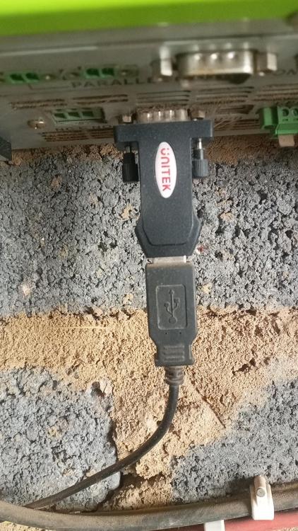

But it intrigues me that you dont have rs232 or usb connectivity on your Axpert. What model is that?
Name plate says MPS 5KVA. Visual inspection shows a RJ45 and RS232.  No usb. I have never got power watch to connect. I think they are for battery and parallel operation.

Pics of the bottom and face?
