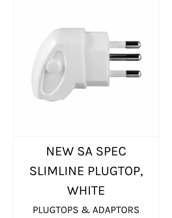

January 19, 20242 yr Author 14 hours ago, JayMardern said: What about if the outlet installed is a 2-pin-only? And change the plug of the meter hand-held to 2-pin to match (if necessary)? This will exclude any device that needs EL? Next question. Where do I get a 2 pin plug? Or even the new SA standard 3 pin. I can get the sockets easily enough. The plugs are a different matter. OK... a lot of devices that need those plugs come with them on the end of the power lead, but if I want to fit one? And I do. The hand held unit for the new meter comes with an SA standard 3 pin plug. The earth pin is physically present, but not connected. Helpfully, there is no information on the device as to how much current it consumes. But also, how much CAN it be? The power lead is stampled 2.5 250, which I assume to be 2.5 A and 250V. Edited January 19, 20242 yr by Bobster.
January 19, 20242 yr 2 hours ago, Bobster. said: Next question. Where do I get a 2 pin plug? Or even the new SA standard 3 pin. I can get the sockets easily enough. The plugs are a different matter. OK... a lot of devices that need those plugs come with them on the end of the power lead, but if I want to fit one? And I do. The hand held unit for the new meter comes with an SA standard 3 pin plug. The earth pin is physically present, but not connected. Helpfully, there is no information on the device as to how much current it consumes. But also, how much CAN it be? The power lead is stampled 2.5 250, which I assume to be 2.5 A and 250V. Yeah I suggested this because I figured the prepaid comms system doesn't use Earth as, similar to yours, my Earth is conductive on the plug itself (it's not a plastic dummy pin), but on the hand-held, the socket it goes into has a 2-pin figure-8 (C7/C8) connector. (This also means in my case I could just swap my cable from the supplied 3-pin to a standard figure-8 (C7/C8) 2-pin cable since the cable isn't hard-wired), You could pick up a 2-pin plug from Takealot: https://www.takealot.com/2-pin-round-plug/PLID72109866 I ran my handheld unit (an Empire Hexing unit) through my kill-a-watt whilst letting it connect and after 20 minutes it had topped out at just 3.3 watts.

January 19, 20242 yr 12 hours ago, Bobster. said: Next question. Where do I get a 2 pin plug? Or even the new SA standard 3 pin. I can get the sockets easily enough. The plugs are a different matter. OK... a lot of devices that need those plugs come with them on the end of the power lead, but if I want to fit one? And I do. The hand held unit for the new meter comes with an SA standard 3 pin plug. The earth pin is physically present, but not connected. Helpfully, there is no information on the device as to how much current it consumes. But also, how much CAN it be? The power lead is stampled 2.5 250, which I assume to be 2.5 A and 250V. Cables will be stamped based on their rating. They will never be in line with the device on which it is used. Cannot tell you where to find the new ZA standard but have seen them in electrical outlets. May be Google L-R Merlin Web or AC-DC. Edit: New plug top available in white or black from Lite-Glow Randburg. Edited January 19, 20242 yr by Scorp007
