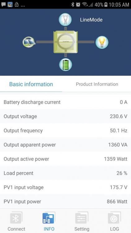

AXPERT INVEREX 5.2kw output watts problem
i have instaedl inverex 5.2kw VM3 inverter its work good with battery and utility but problem on PV
I get it when I check with the meter PV volts and amp ( on meter 180v and 14amp )
but Inverter only 850 watts output
i have 12 panels 250 watts

Same problem with me,
Just bought 5.2 KW VM3 invrex ,
Installer 10 ×250 watt panels ,
I have not installed any batter yet .
So when my load is 300 watt ,PV out put shows around 200 watt out put,when I put more load like 1100 watts suddenly the PV out put reach around 860 watt.
I don't know what is the problem,
Any One can guide ?

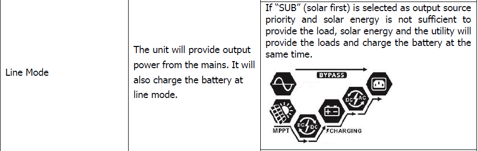

I'm not used to these newer models, which seem to have a powerful AC-DC converter, separate from the main inverter (an AC to DC converter). So they can combine mains and PV power, at the DC bus level (around 400-500 VDC). This is facilitated by the 450 V PV max models, which boost the PV voltage to 400-500 VDC, rather than buck it down to battery voltage.
It would seem that if there is plenty of PV power, there could be zero mains power. But maybe that's difficult to control, and maybe that's why PV power is less than load power in all the examples so far. I doubt that the PV power could ramp up to cover a sudden load increase, and maybe there are limits on how fast the AC to DC converter can ramp up the power as well. So maybe it's easier to have a few hundred watts of AC to DC converter power, so it's easier to ramp up or down in case of load changes. Perhaps sudden large load changes have to be handled by switching to pure bypass mode, as in a relay kicks in. But then, if it was a sudden large load decrease, and there was significant PV power which can't quickly be ramped down, where does the excess energy go? The DC bus capacitors would not have enough storage.
If a battery is present, it can provide the instantaneous power increase, so there is no need to keep some AC input power flowing, and no need to switch to bypass mode, unless of course the inverter is now overloaded.
But the power flow diagrams on the LCD (as depicted in the manual) seems to suggest that in line mode, the relay is always on (there is a direct straight line marked "BYPASS" from AC in to AC out). This suggests that the power blending occurs at AC (at the inverter output), not DC (at the inverter input), so it's a true AC coupled system. But then there is the usual problem where sudden decreases in load might cause brief exports of power, which I would imagine would not be allowed in this type of inverter, and in some locations it might be strictly prohibited (perhaps by a power meter tripping).

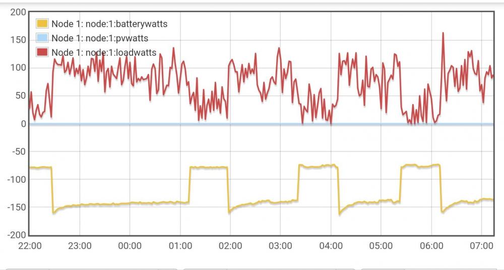

Below a graph in the night, when thee is no solar production. You can see batterywatts instead pvwatts1. I think in this case the data is OK.

Same graph, but with batterywatts in positive, to easy analyze.
As far as I know, the Inverter autoconsume is not integrated in loadwatts, and it is about 50w. This is the small difference. I mean, the data is ok at night (batterywatts vs loadwatts) but not in the sunny hours (pvwatts1 vs loadwatts)

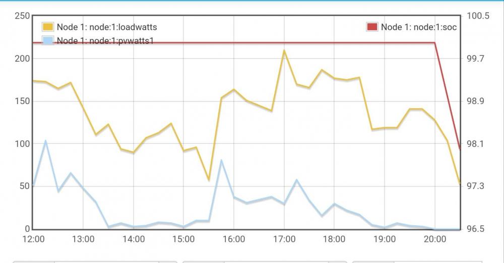

Yesterday daylight hours:
As you can see, until 13 the battery is charging and the the figures have sense, pvwatts1 = batterybatts + loadwatts. However when the battery is fully charged I can´t understand the figures; pvwatts1 is not enough to feed the loads, and battery is not apporting anything.
Detail from 13:00h:
If the graphs are correct, the rest has to be coming from AC-in. Is that possible? Is your inverter (in these conditions) in line mode? Like this:
So basically, when it's doing this strange stuff, do you see that line from AC-in to loads with "BYPASS" under it?
In this mode, the loads seem to be able to be supplied from the battery and/or solar via the DC-AC inverter, and from the mains at the same time. I would not expect your inverter to be in line mode after just having charged the battery, but if so, that can probably be fixed with settings (either on the inverter itself, or on ICC).

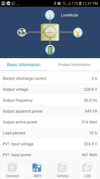

Inverter LCD screen values (pv input Watts) and ICC pvwatts are identical.
So my problem is the same looking at ICC data or LCD screen data.
My inverter show me less PV Watts than Load Watts 😱. Obviously this is impossible, because there is no mains and battery is apporting 0 Watts.
