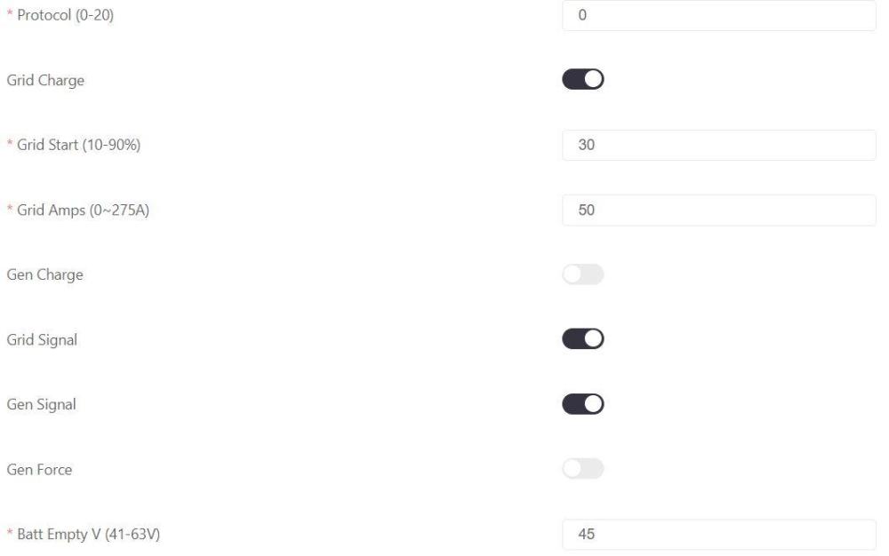

CTskollie Posted July 9 Share Posted July 9 Good Day All, I just need some assistance to confirm all my settings are correct, I set my SOC to a minimum of 20%, i noticed this morning however my battery dropped to 0%. I also noticed some weird spikes in the battery percentages on some days but never thought anything of it, I set my SOC to a minimum of 20% with no grid charging. Am i missing a setting that my battery is dropping below this level? I thought the battery would hold at 20% until there is enough solar to charge it up again but won't drop below the minimum SOC. I changed the setting to grid charge now and the battery is charging normally now but just want to check if I am missing something here. Battery went from 20 normally down to 17 and then just down all the way to zero. Should i request a firmware update perhaps? Inverter is a Sunsynk 8kw and BSL7kw battery. Quote Link to comment Share on other sites More sharing options...

CTskollie Posted July 9 Author Share Posted July 9 (edited) Agreed that it is normal, I cannot however see with no load why the battery dropped below 20% and then a massive dip from 17% straight to 0%. With my minimum SOC of 20% should the battery not hold at that level and use grid when battery reaches that level and not allow it to drop further. Edited July 9 by CTskollie Quote Link to comment Share on other sites More sharing options...

CTskollie Posted July 9 Author Share Posted July 9 6 minutes ago, Shadders said: I often see big changes in SOC when the BMS encounters a fault such as a single cell under voltage. How old is the battery? Numerous battery manufacturers recommend a full discharge and recharge cycle to calibrate the SOC reading on installation. It could be that your battery hasn't had the chance to do this yet and so the SOC was out of whack. Other thing to watch out for is that the inverter might have lost coms with the battery and defaulted to the voltage control settings. BMS_Err_stop isn't checked so the system won't shutdown or show the error pop up. Battery is about 4 months old now, done a full recharge this past Saturday as battery is currently only set to charge from PV. Should the BMS_Err_stop be checked? Quote Link to comment Share on other sites More sharing options...
CTskollie Posted July 9 Author Share Posted July 9 5 minutes ago, Shadders said: Yes it should do that, was grid available? Grid was available yes and was running off from the grid during that period. Would it still deplete the battery with the grid being available below the minimum SOC? Quote Link to comment Share on other sites More sharing options...

CTskollie Posted July 9 Author Share Posted July 9 21 minutes ago, Bobster. said: Two things 1) what is your grid voltage like? My system is set to stop using battery at 40% SOC and resort to grid (so that I always have some battery in case of an outage), but one day whilst the grid was up, it went past 40 to about 35. Shouldn't happen! But the incoming grid voltage was low, the inverter had disconnected and as far as it was concerned it was running off grid and now could start using the reserved charge in the battery. 2) at what SOC does your battery shut itself down to protect itself? Mine will shut down, irresepective of any settings on the inverter, at 10%. At which time the inverter will see zero % SOC because the battery is shut down and will not be sending any information to the inverter. How would I check my grid voltage, last I suspected a faulty breaker i checked and the mains was 230v but not sure if it can be monitored in real time. Shut down I set at 20%. Quote Link to comment Share on other sites More sharing options...

CTskollie Posted July 9 Author Share Posted July 9 Apologies for my ignorance but how would i access the BMS setting. Is thus accessible on the inverter? Quote Link to comment Share on other sites More sharing options...
