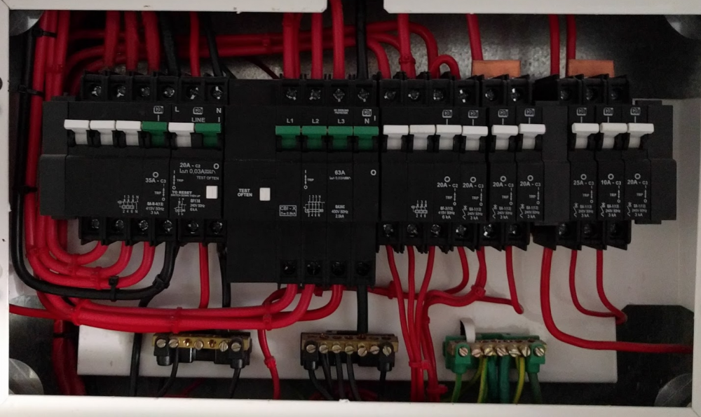

My electrician has been trying to hook up my inverter to the DB for 2 days now and no luck. I have a 3 phase system and trying to power up 1 phase(Blue phase).
When I turn my Changeover switch to inverter mode(switch position 2) , the earth leakage on the main DB drops IF eskom power is on, but if Eskom power is OFF then the earth leakage stays on and my batteries power the phase.
When I turn my changeover to Eskom supply (Position 1) , earth leakage stays up and I'm getting supply from eskom.
Problem is , I've got to go manually change the switch during loadshedding.
Can the experts please have a look at the way it is connected and advise.

Are you sure Neutral Bar 1 is fed from BEFORE the RCD and not after it? Neutral bars are typically connected after the RCD. If that is the case, your Axpert's live side is possibly fed before RCD and the neutral after it. Easy mistake to make.

There is more wrong with this. What the heck is going on with Neutral bar 2? That is fed from the grid-side RCD, as well as by the inverter, with the changeover apparently just switching it back on itself (ie doing nothing). Wired like this, the bypass switch in the inverter is also bypassing the neutral on the RCD. No wonder it is tripping.
May I humbly suggest a different electrician? Is that being too forward? 😛

Also,
That yellow wire with the ugly strip-frayed insulation, that is temporary right? Obviously no good in a finished installation 🙂
Red wire from neutral bar to changeover... wutt?
The blue wire going around the red/yellow to get to the earth bar... blue for earth?! And it looks like it is only 1.5mm^2. Earth must be sized for the full fault current.

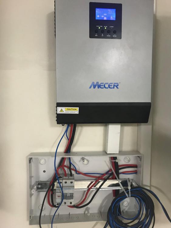

Got a new electrician to come around today. He spent an hour , and its fixed!
He says he has to clean the box up a bit but it should be working fine. He says my changeover switch was reading voltage even in the "off" position.
Here's what it looks like now.
