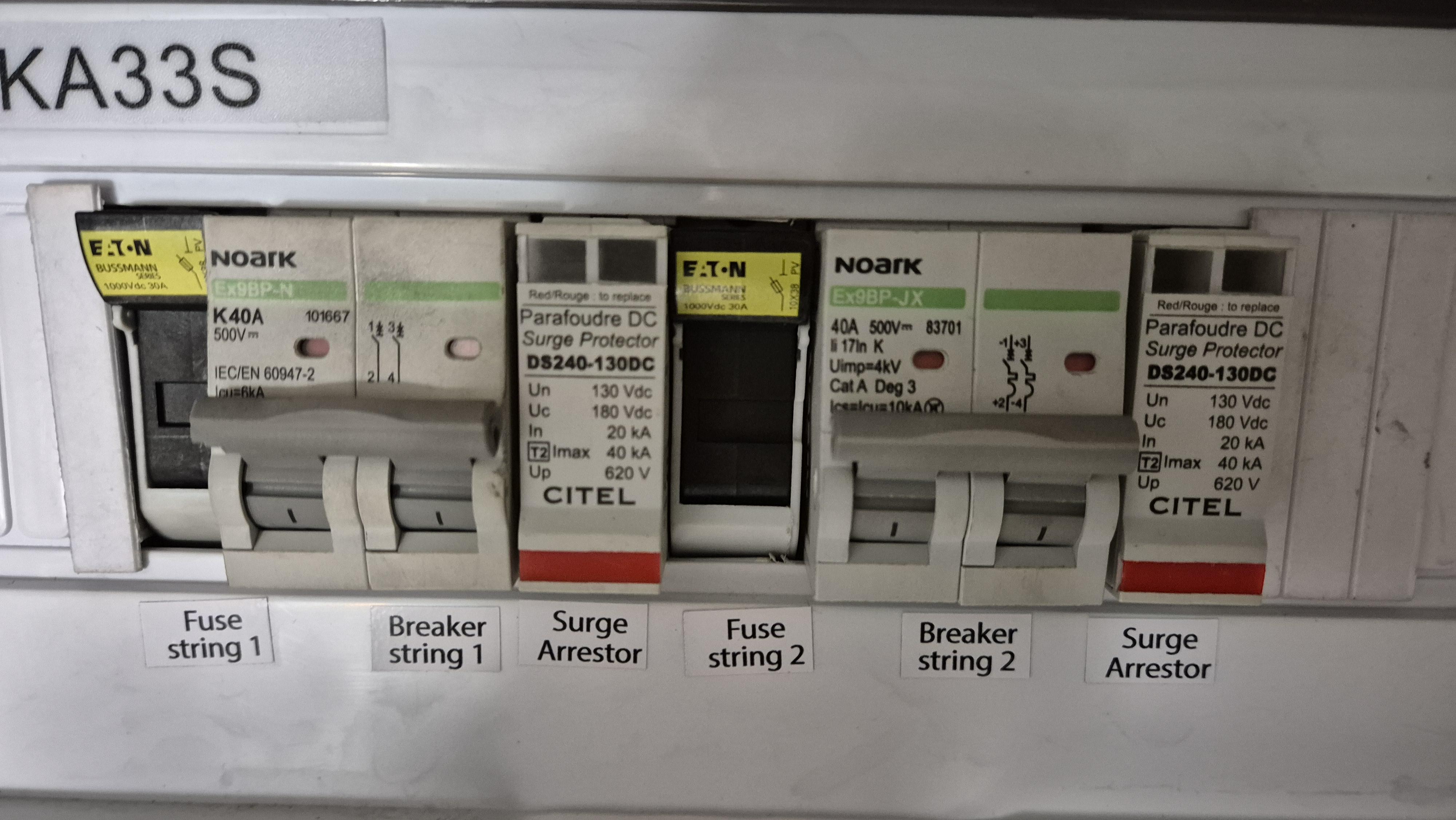

Oh... The protection. I'm attaching a shot of the DC board to show what is in place for each string. Can these be retained?
You can leave all the protection as is. If the fuses are a tad too low you can go up to 32A which should be fine.
