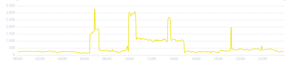

Also the run times are surprising. Here's my system on the 8th. I've reduced this to load only
We see
  1. the heat pump turn on at 6:30 and run for 50 minutes.
  2. the element turns on at 10:00 as per the automation and runs for 35 minutes. The automation allows the ASC to be on until 12:00
  3. The heat pump comes on again at 13:30 and runs for 15 minutes
  4. Although the automation switches the ASC on again at 13:00, no more power is drawn on that circuit.
OK... it is possible that the spike at 13:30 is actually the guest geyser. I was not sitting watching devices all day. But we see a similar pattern the next day, and this time the midday spike cannot be the guest geyser because that ASC is turned off from 12:00 to 13:00

As regards point (1) above, looking at the area beneath the line on the graphs should give a rough figure. So for the 8th the heat pump is adding about 1.4 kw to the load for 50 minutes - that's about 1.16 kWh. Then the 2nd run it adds again about 1.4 kW for 15 minutes. That's another 0.35 kWh. That's a rough 1.75 kWh, and that's in the same ballpark as the figure from the ASC, and also supports the spike at 13:30 being the pump.
At no time do we see the guest geyser running for the allotted 2 hours between 10:00 and 12:00, nor coming back for more after 13:00.
