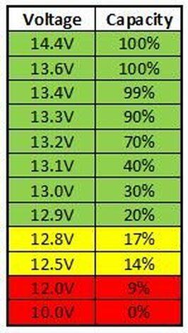

I would not recommend using two different inverters to charge the 4 batteries because
A] If you are using comms which inverter would communicate with the batteries because both cannot communicate with the inverters at the same time - it is like working for two bosses one says go there and to that and the other one the exact opposite instruction.
B] If voltage settings are used there is also the danger that the batteries can be over charged or that one of the inverters shuts down because the other one is charging the batteries to a too high voltage, LiFePO4 batteries has a very flat voltage curve and on the cheaper inverters using voltage settings is risky - See the attached illustration as an example of the flat voltage vs SOC%.
I would recommend that the batteries are split between the inverters.

I disagree on the second point. I have used 2 devices (MPPT and inverter) to simultaneously charge the same bank for a time now.
The only way you will overcharge is if your charging current is set higher than what the batteries can handle.
set both so that the sum of both don’t exceed the max charging current of the entire bank. No competition will occur. You can have a 100 charge controllers on a bank and as long as the current total is within the battery spec it is perfectly fine.
