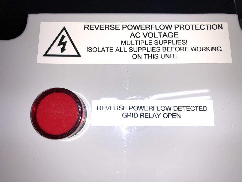

Blinkwater9 18 Posted July 22, 2019 Author Share Posted July 22, 2019 Just an update. Installed the REVERSE POWERFLOW PROTECTION RELAY, Rhomberg SP510, and an 80Amp 230vac contactor. The original picture shows a 50amp 4-pole contactor, but I had an issue getting the 10mm² cables into the terminals, so I increased the amp rating to the 80Amp version, and instead of doubling the the contacts, just used the 3-pole version. I also purchased a CT closer to the rated 63amp supply. Tested the unit by inverting the CT, and it definitely trips out the contactor. I'm sure this will suit my need, for an anti-islanding device, should this need arise. The delays and sensitivity are adjustable, and I intend fiddling with these somewhere down the line. I also increased the size of the enclosure, giving me more space for the heavier cabling. I also left the 50amp contactor on the rail, should it be required later. Quote Link to post Share on other sites
___ 4,122 Posted July 22, 2019 Share Posted July 22, 2019 1 hour ago, Blinkwater9 said: for an anti-islanding device Practically it would probably do the trick, but I'm pretty sure it has a huge NDZ (non-detection zone). I mean, assume the grid has failed and my inverter failed to disconnect, and I'm inadvertently feeding 50mA into my feeder line. That's enough to kill someone, but it's only 10W going in the wrong direction. Still, impressive use of commodity hardware, well built, and like the bootlaces. Quote Link to post Share on other sites
Blinkwater9 18 Posted July 22, 2019 Author Share Posted July 22, 2019 5 minutes ago, plonkster said: Practically it would probably do the trick, but I'm pretty sure it has a huge NDZ (non-detection zone). I mean, assume the grid has failed and my inverter failed to disconnect, and I'm inadvertently feeding 50mA into my feeder line. That's enough to kill someone, but it's only 10W going in the wrong direction. Still, impressive use of commodity hardware, well built, and like the bootlaces. Thanks. The bootlaces do make a neat build. You should see my wire markings?LOL. Wrap-around thermal labels, on all the wires. My thinking here was, should I need to move something from Non-essential to Essential load, I would need to move the neutral and earth too, as each is seperated. This way, I don't need to search for wires. To be quite honest, I'm not concerned over a momentary feed-in or spike. What I want, is should the grid go down for any reason, I want the disconnection to be made. Also, I imagine, should any compliance be required later, I seriously doubt that anyone will be able to confirm that the this unit would not fulfill the requirement of an ANTI-ISLANDING device. And on the point of tripping the pre-paid meter. I am lead to believe that on my meter, the feature to shut down on reverse power detection, is disabled. I think, if legislation requires a device to prevent REVERSE POWER FLOW, then at +-R2000, this unit should fulfill the requirement. The way I understand this issue, there are 2 clear terminologies that are used? REVERSE POWER FLOW DETECTION, and ANTI-ISLANDING. Reverse power flow detection/prevention, should react to prevent the electricity meter from seeing this as an attack, and Anti-Islanding is isolation from the grid, to protect maintenance workers from electrocution? Lets see some opinions? ___, Mark and JacoR 3 Quote Link to post Share on other sites
