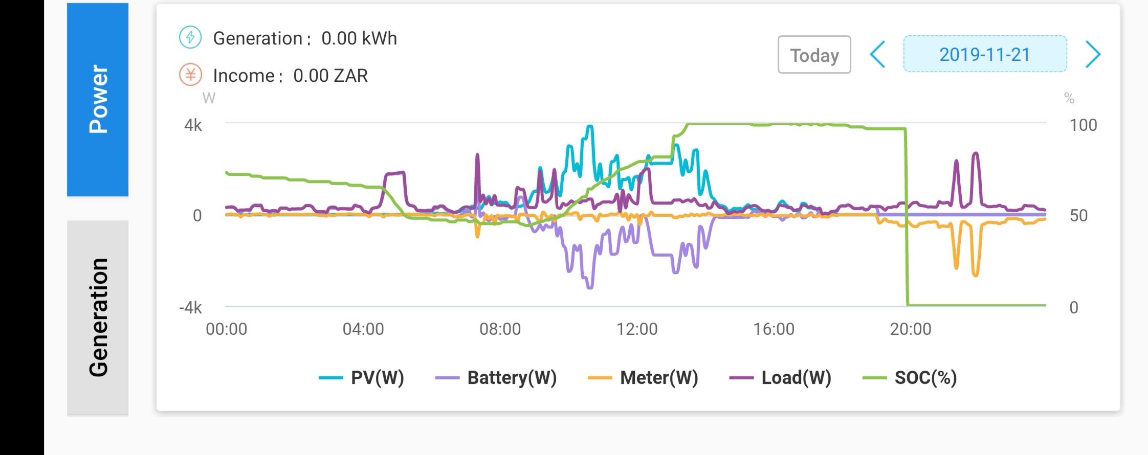

Im posting the graph from 21st that shows the battery closing down in the evening when the load was not great.
to me it looks like a battery problem (or the connection from the battery to the inverter). Can you please generate the SEMS portal battery voltage report (see attached example)  for the 21 and publish it.

that basically confirms why the inverter reports 0% SOC after it detects no power on the battery input. At least we have narrowed it down a bit. It could still be either the inverter or the battery. The probability that it is the battery is however much higher. I propose to look into the battery first. I would send the graphs to Revov, let them access your station on the SEMS portal and demand action.
