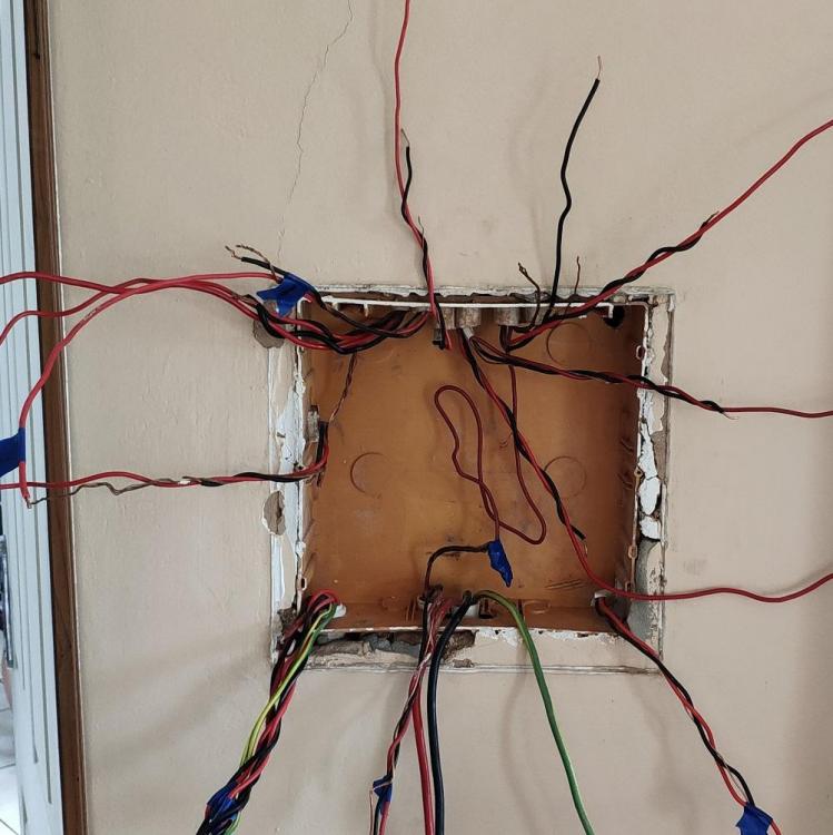

Spent some time today in the DB board, the aim being to identify which neutrals went with which circuits for when split them out to the inverter DB board.
Before
* please note the bottom left corner, is a somewhat melted.connector I'll get back to that.
During
IMG_20200111_110003.thumb.jpg.064231d2330d392c2f57e185049e812e.jpgIMG_20200111_121917.thumb.jpg.a5a417d3dcd725593ae02af50a3ade78.jpg
* please notice the now taped up connector in the middle of the DB board. This little bastard gave my fingers a tingle, even though the house is disconnected from the grid at the edge of the property, and no alternative power supplies are currently installed.
After
Not much different, but everything is labelled, vacuumed, neutral identified ready to be split, essential load lives ready to be taken to the inverter DB board, and dodgy breakers replaced.
But, that little bastard that I mentioned before...it had power, even though the house was disconnected from the grid, and I don't like that.
The little block it was connected with was melted, so something is amiss. It also passes through the DB board, not connecting to anything except neutral.
I've replaced the melted connector with a beefier one too, and taped up.
I'm going to have it checked out, but for the time being any ideas?

Anyway, I'm done with the main DB board for now. Fixed the daisy chain, replaced with a 63A busbar, and most of the breakers are now the same (couldn't fit the busbar with the mixture of Majortech and ABB breakers, so just populated all with what I have.)
