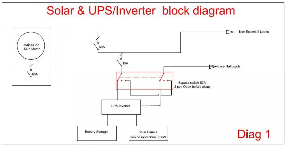

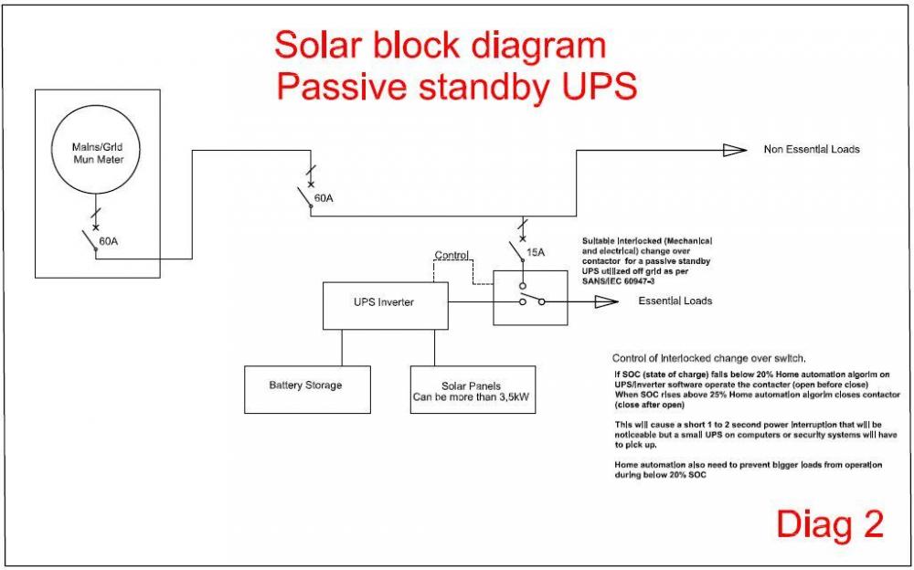

HI All
As a user for some time now I share my experience on the 15Amp limit and how to manage it. I have two Axperts (2x5kVA), 6000W PV and 12kWh storage.
It is deemed as a UPS with solar charging. Not a SSEG connected to the grid.
I post these four diagrams for use to users that want to install more than 3500 watt of solar panels and have battery storage. In my case I utilize shore power (municipal power) for between 3.6% and 12% of the time per month over a 12 month period. There are many days (even weeks) when I do not connect back to shore power at all, but I need shore power when cloudy days persist for many days at a time and battery drops to below +-20%. August is the worst. Connecting back to shore power usually happens between the hours of midnight and say 09h00 at the latest the following day. In August it is longer, but it is only for that month.Solar block diagram 1-4.pdfThe purpose of my system is to be independent of municipal power as far as possible, and If the basic service fee increases to such an extent, then I will go completely off grid and operate a remote start generator for the 3,6% to 12% of the time.
In diagram 4 you have the best of both worlds. A Bypass switch, is very useful when things go wrong, but so is a suitable change over contactor that is operated by the software on the inverter. Diag 1 and 3 are similar but in diag 3 the bypass can handle more than the 15A as is currently allowed. In any case manage your loads via software or timers. Use the washing machine, tumble dryer and dishwasher when the sun shines.
Any comments or questions will be welcome.Solar block diagram 1-4.pdf
Link to post
Share on other sites
41 minutes ago, HennieW said:
HI All
Do I understand this correct:
To circumvent (or rather comply to) the 3.5kW requirement of COCT you simply install a 15A breaker?  (15A x 230V = 3.45kW)
Then it is up to you to manage the 3.5kW draw from the grid. Hardware or software management however you want to do it.  The 15A breaker is a fail safe from COCT view that you will not draw more than that.
If this satisfies COCT it kinda makes sense to me. Adding an inverter but limiting the draw to 15A.  It is like saying yes you can add another geyser to your home but as long as it is below 3.5kW if you have a 60A breaker, nevermind if it is on or off or you feed it power mostly from somewhere else.
Link to post
Like what you are saying that an off grid inverter is a UPS with solar charging and not a SSEG (it does not push power back to the grid)
Supplying a Hybrid inverter with a 15A breaker should also work then.  You will just have to balance the loads on grid side vs off grid that you don't try to feed more than 15A to the grid connected loads or do some form of load management.  For me it would be easy. Put everything on the backup side and only the geyser and oven on the grid side but use a load control so that the geyser switch off when the oven is in use.
Link to post

HI Piet
You are correct in what you are posting.
The Inverter must conform to the SANS code for a UPS system. Look up the SANS code for inverters and your electrician must also sign it off as such. Then also the UPS maximum charging current  from the municipal grid (draw and push through to the load) must be limited to 25% of the main breaker (60A) size. It must be a hard limit. i.e Breaker of size 15A. is preferable. The software limit can be easily changed and is not recommended. However during sunny, sunshine days you may push to the load as much as needed from the sun and battery, but not draw from the grid more than 15A. Usually the load is drawn from the sun and batteries at the same time or from the battery only or from the sun only. It is the SBU setting  (Solar battery and then utility), but in utility mode up to max 15A.
I feel very sorry for the municipal guys that need to manage their grid as the grid was not designed for load shedding. Full stop. Look closely at this photo of the supply voltage quality the first couple of minutes after load shedding. It is terrible and will cause failure. That is why I recommend you place all your sensitive equipment on the UPS.
The 25% load limit is placed there because the grid cannot handle more than that AT THE SAME TIME.  After load shedding this is what happens to the grid voltage. You are warned.1878975401_Loadsheddingnonsens.thumb.jpg.2b49146f1a612f2babeab83f69561f61.jpg
