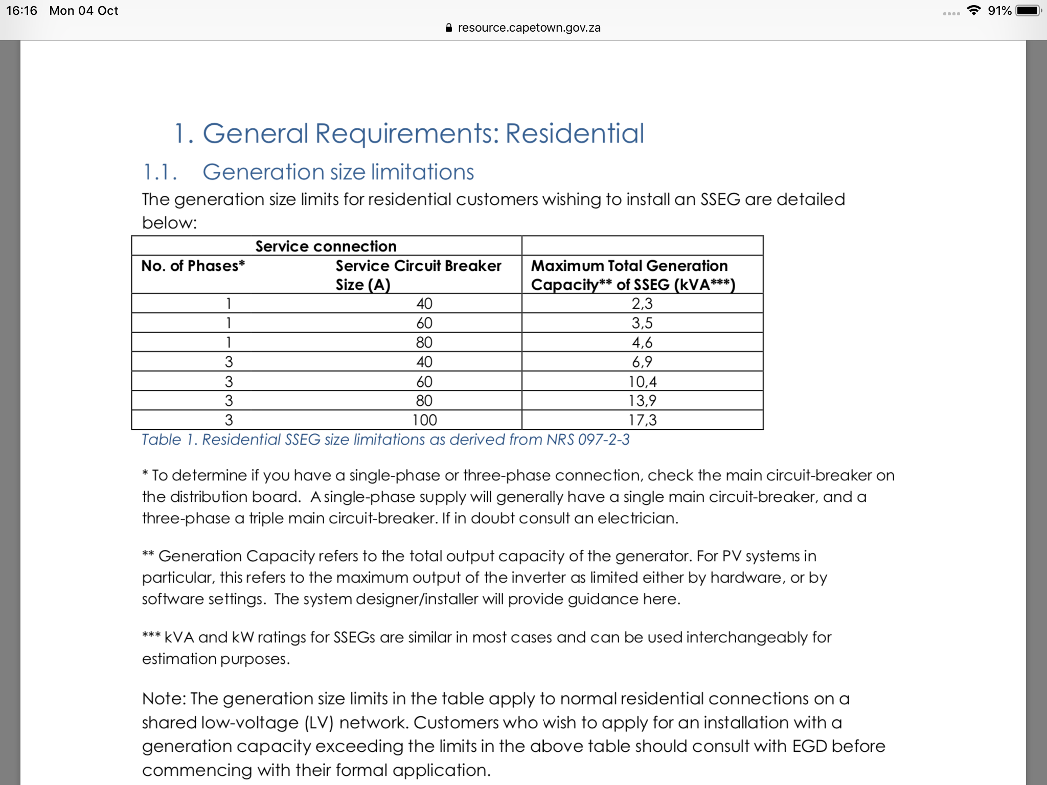

So I chatted to one of the bigger solar installers in CT today. According to them, you can put a 5kw grid tie inverter on a 60A residencial circuit in CT, just as long as you never put more than 3500w of panels on your roof. That way, the inverter can never invert more than 3500w. Sure the batteries can further contribute to it, but the batteries will never give anything back to the grid so thats fine.
Im not sure if this is correct, but it is what I was told, and they would get it signed off + engineering papers ETC.
Link to post
Share on other sites
I sometimes wonder if they wrote the rules with an SMA system as the reference (everything AC-coupled, separate battery storage). Because we're told the limit is due to the pickup. If I have a 5kVA Multiplus installed, it can push 4kW into the grid to offset loads. If it trips, the pickup is 4kW...
But let sleeping dogs lie I say 🙂
Link to post
i can confirm that. They have signed off my system. You can even have more that 3.5kW of panels on the roof if you can proof that (because of all the losses) the inverter output is not exceeding 3.5kW. I have 4.4kW on the roof 🙂. As @plonkstersays lets sleeping dogs lie regarding the pickup concern if you have a hybrid inverter with batteries 🤣.
