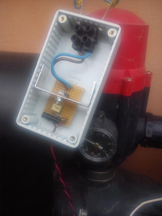

Indeed. Cause internally it is usually a TRIAC, and those things have a voltage drop and a bit of series resistance. For example, here is the spec for a fairly common TRIAC:
You can see a fairly constant voltage drop of between 0.7V and 1.1V, depending on temperature, and an additional resistance of around 0.25Ω on top.
So your average 3kW geyser at around 13A, gives a good 4.something Volt drop and will generate a good 60W of heat in the process. So I'd probably not want to use this particular triac for the job then...
Most TRIACs will have at least that voltage drop, so at 13A you will have a good 15W or so of heat to put somewhere (at the very least). This is where you then need to consult the specification for the thermal resistance, and if  that is in spec, then you can do some more math to determine how much heatsink you need to put on it (heatsinks are rated in °C/Watt), and then you need to keep that thing below 125°C.
Long story short, the aluminium base of most SSRs is way too small.
Here was a more practical setup that I tried once. I used the "master valve" output of an irrigation computer (24VAC) via an opto-triac to start the well pump. I used scrap material, all of this came from other things, even the aluminium. This thing ran at a good 70°C... for an 850W pump.
It died some weeks later when water got into it and it burned a big hole through the stripboard... After that I scrounged a 24V relay from the scrap pile (used to be from a garage door opener) and used that instead.

Just to add a bit more. The input voltage doesn't switch the Triac directly. The input voltage lights up an LED, inside a little package called an opto-coupler or opto-traic (the photons emited by this device pushes the other side into conduction). In my photo above, that's the whitish package with the MOC part number. The other end of the opto-triac then switches the real triac (the black 3-legged thing in the TO-220 package).
So the SSR probably incorporates a small linear regulator that operates from 3V-32V, and this powers the LED inside the opto-coupler. This means a really low current is required (under 10mA) to switch it on, since all you need is to light up a LED.
(My hacked-together circuit above simply uses a 3.3k resistor to drop the 24V to something suitable and naturally does not have the same range).
Since it is doubtful that the makers would have bothered with an SMPS to get the wide input voltage range, a lower voltage will likely be better. 5V at 10mA means you need to drop 3V (aproximately) to get it down to a good voltage for the LED, at 10mA, that is 0.03W of heat.... which is nothing. But as you push it up to 32V, it's 0.3W, which is beginning to be something... 🙂
