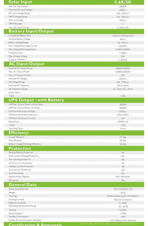

Quick one has anybody had any experience with the luxpower products specifically the 5kw hybrid, I'm looking to purchase one and would appreciate any feedback from installers,users/owners.
Product marketed as a hybrid in inverter that is able to blend from all 3 sources PV,Battery and grid. Specs attached

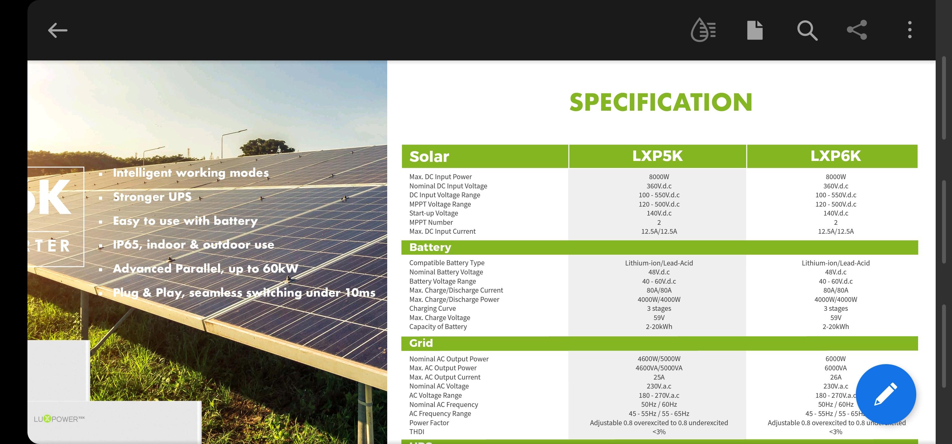

Luxpower Off-Grid.pdf
