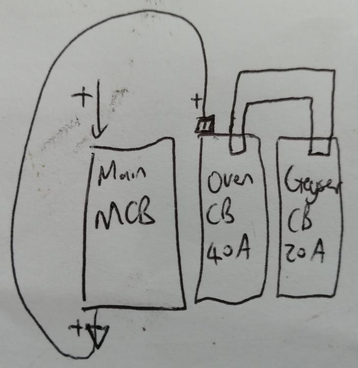

Hi Guys
What is typically the wiring sizes used in house wiring and DB wiring?
1) The size of wiring used in light and plug fittings
2) The size of the wiring used in DB for stuff like geyser and oven.
3) What is the best way to bridge wiring on DB circuit breakers when using the thick wiring (geyser/oven) when you need two of the thick wires into one CB or even busbar+thick wire? Best practice, what is safe and what not, etc. Is there a limit (regulations) on how much stripped wire can stick out above the CB, etc.
Just need to confirm based on what I have seen in my DB.

1)  1.5 and 2.5 mm
2) depends on power rating of both: 2.5 or 4 mm (see attached)
3) Use cross connecting link (solid copper link) for as many CBs as required.
