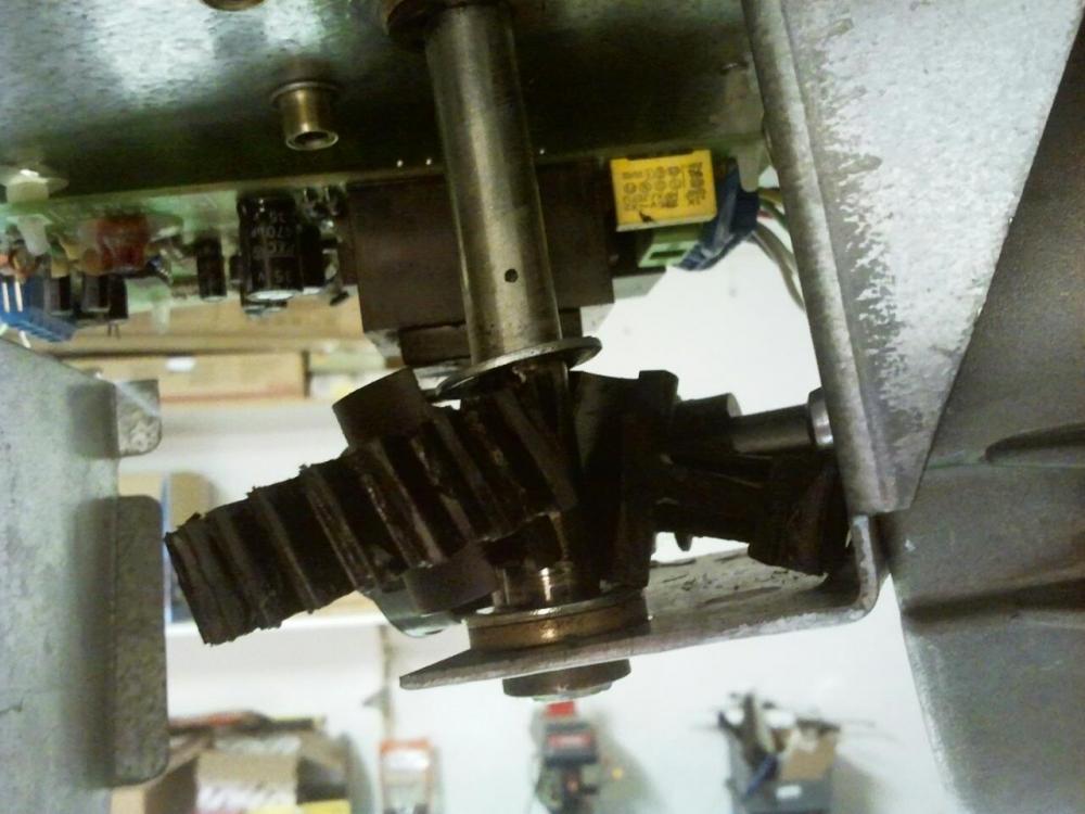

I had one of those... but it broke way back in December 2012. This is what the big worm gear mechanism looked like:
These door openers have a normal 230VAC induction motor, and as a result it will have somewhat of a start spike, generally about 5 times its nominal rating. I suspect that's the issue, it simply overloads the inverter.
I have since thrown the remains of it away, but a it of googling indicates it has a 0.5 horsepower motor, which is just short of 400W. That would need a good 2kw kick when it starts. While many inverters (including the voltronics) can handle a 200% spike for about a second, I suspect your's is JUST a tad outdone by that motor.
A new low-voltage motor is around 2.5k and well worth it imho.
