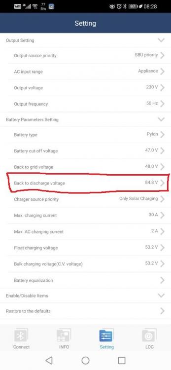

Ok so after i reset the inverter last week and disconnected all the Power sources it was stable for nearly a week only to get this again today.
Here you can see the "Back to "Discharge mode is set to 84.8Volts (Normally its 87Volts) so i give up on this makes no sense. It will now stay like this until i reprogram the inverter. before i left it for 3 days and it just stays like this. Reprogram required. Any new ideas for me Thank you.
Ok, that does sound like a firmware problem. The Axpert King firmware is updating rapidly, perhaps partly as a result of @HubbleLithium working with the manufacturer to get things working with their battery. I have no idea whether the Axpert VM III firmware is updating as rapidly. I suppose it's possible that no-one has complained yet, so they're waiting for the King firmware to settle, then they can apply those changes to the VM III source code (or however they do that).
But you'll need to get your supplier to talk to you and liaise with the manufacturer to get things happening. If you can't get a response, perhaps it's time to talk to the consumer watchdog (I have no idea what that body is in South Africa; I'm based in Australia).
