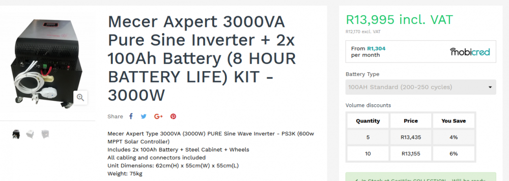

If you want something that does not need to be installed, and all your essentials are on one plug, you might want to look at one of those portable trolley inverter kits. This one from takelot is just an example, I don't have personal experience with it. It will run you under R15k for the inverter and 2 deep cycle batteries.
This one will do all that you want and more. Just keep it plugged into the wall and your devices into the inverter and it will change over automatically.
https://www.geewiz.co.za/long-run-ups-inverter-battery/93614-1030-mecer-axpert-3000va-pure-sine-inverter-2x-100ah-battery-8-hour-battery-life-kit-3000w.html#/132-battery_type-100ah_standard_200_250_cycles
Edited by GVC
You just need a UPS. Those Mecer's aren't bad UPSes. Though of course I'd still love to rather sell you a small Multiplus, like the kits Sustainable have (comes with a LiFePO4 battery with significantly better cycle life).
Must say though, I love how the above ad advertises an 8-hour battery life without saying what kind of load it can do for that 8 hours. If your total load is under 300W, and you kill the batteries completely every time, then yes, you'll be able to do 8 hours. Your max continuous load will be around 500W (that would give a pretty steep C/5 discharge rate on the batteries).
500W should be sufficient for the appliances you listed though.

Here is where things can seem to become too technical but soldier on...., batteries will specify their voltage (12V, 24V, 48V most common) and their storage ability (in either Amp hour (Ah) or Watt hour (Wh)). Lithium batteries often specify the capacity in Wh and lead acid batteries in Ah. So how do you decide if a given battery will be "big" enough? Lithium just compare the Wh numbers. For lead acid (like the adds posted in this thread) take YOUR Wh number and devide it by the listed battery voltage. The first add has a single 12V 100Ah battery. So...2500Wh/12V = 208Ah. You will need a 208Ah 12V lead acid battery to power 500W for 4 hours - so a single battery like the one add will not be enough since it is a 100Ah battery. You can connect two 100Ah batteries in parallel then you will have a 200Ah but still 12V battery, so two of  those batteries might be needed (or maybe two 60Ah batteries?....read on first).

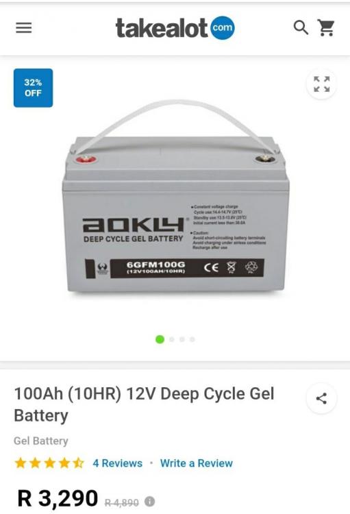

The second add says it comes with 2 batteries.... but if you check the specifications you will likely find that the inverter works on 24V (the two batteries are connected in series), so you have a 100Ah 24V battery (even though it is made with two 100Ah 12V batteries).... will the 2 batteries be big enough?... 2500Wh/24V = 104Ah... so this is closer.
BUT lead acid batteries do not have a very long total life before they "break" if you tend to use more than 50% of their capacity. So if looking at lead acid battery systems you will make life simpler if you take your power requirement and double it from the start. 2500Wh * 2 = 5000Wh.... 5000Wh/12V~400Ah.... or 5000Wh/24V~200Ah. So whether you go with 12V or 24V you will need at least four 100Ah batteries (or eight 50Ah batteries or two 200Ah batteries). Lithium batteries will generally let you use about 90% of their capacity but lithium is heavy on the pocket (depending how you do your sums)

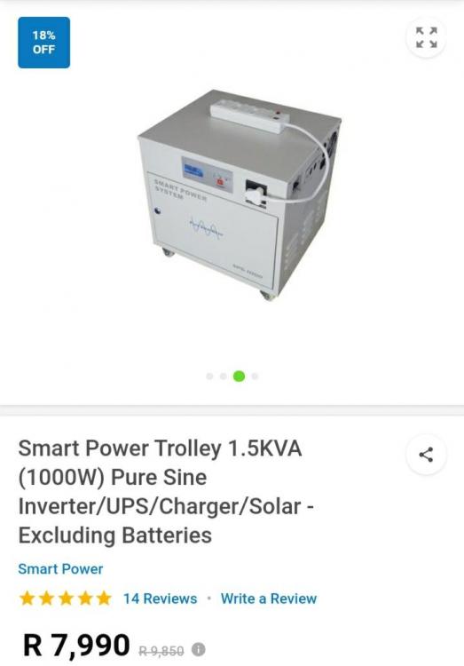

Any of the mentioned systems should meet your inverter requirement but I suspect you will end up with a flat battery often and/or have to buy new batteries after a couple of months.
The "off-the-shelf" solutions can generally be made up cheaper by just combining everything yourself. I would personally not install the Axpert inverter laying flat though (like in the add)... pretty sure the unit thermal regulation was designed around a vertical install. If you can change a plug on a toaster you should be able to make up a system - especially for your listed needs. If not comfortable doing that - no shame in that (and stay out of the DB!).
Another option to the miriad of "ready made" UPS type systems that you can look at in your budget is something like a DIY victron multiplus 12/800 inverter charger (R8500-9500) combined with a second life Mecer 200Ah/2500Wh 12V lithium battery (R6400-R7500). Add a victron Mk3 USB cable (R1200) so you can make some changes to the inverter settings from a laptop. Get a battery place to make you up some 25mm2 cable with properly crimped lugs, add a fuse between battery and inverter, put it on trolley in a box (make sure the battery terminals are at least covered) if you want and you should have the lightest, least intrusive system that should meet your power needs in terms of inverter power, fast enough charger for most load shedding scenarios, and with a bit of careful load management your total storage capacity should be enough.
The axpert type systems definitely are lower cost and simpler (no extra cable/laptop needed for changing settings) and you have a screen to see what is happening. Especially the 3000W inverters give you more options to power something like a kettle if you really need to (not gonna do that with a 800W any inverter). The axpert type systems also generally add the option out of the box that you can add solar panels later without needing any other bits than solar panels, solar cable and solar fuse/disconnects.
If you think/gamble that load shedding will only be around now-and-again for a day or two and you want to keep this grudge purchase as cheap as possible, then also consider just battery, a separate smallish inverter and a loose battery charger. (keep charger connected to battery, when load shedding comes around, hook up the inverter... when load shedding goes away again for 3 months... put inverter in cupboard). Here you will just lose out on the automatic/"seemless" switch over when load shedding happens that you get with the axpert/multiplus type systems.
If going axpert type system - try and make sure it is an original voltronic produced inverter (quality and support on the clones seems somewhat iffy).

Right so after rabbit holing for a week I have decided to go with one of the 2 options and be done with it lol
So if you had the choice between the 2 which one would ya order? :)
https://www.geewiz.co.za/load-shedding-solutions/111207-1048-axpert-type-pure-sine-3000va-inverter-2x-100ah-battery-8-hour-battery-life-kit-3000w-80a-solar.html#/132-battery_type-100ah_standard_200_250_cycles
Price is negligible between the 2 and I will just replace batteries one day, or hopefully buy a place and get a proper built in system, for now one of these seem will serve my immediate purpose.
It's exactly the same inverter. Voltronic makes them, and other people rebadge them.
That's a budget inverter. Of course there are plenty worse inverters on the market, and this one is not a bad one for just a UPS... but you will buy something else within the net 5 years or so. That's almost a given 🙂

My experience with this is that you have basically two groups of batteries. You can buy below 5k ZAR or above it. Now most people are going to buy the cheaper battery because they just spent 9k-10k for the inverter-trolley... so quite understandable the spectre of increasing that investment is somewhat adrenaline-inducing. But the trouble with those cheaper batteries is that they just don't hold up, regardless of how well you treat them. One year in, maybe 18 months... there you are with one bad cell neatly packaged with 5 good ones, and no option but to replace the entire bank.
Treat them badly, eg discharging them too deeply, and you're looking at not even 6 months.
If you buy a good AGM battery though, and you treat them well, you could well be okay for 3 years or more. And by good I mean something like your Victron AGM or Gel batteries.
However, what happens to most people is that once load-shedding stops, you forget to look after the batteries, until the next time load-shedding starts. In an ideal world just keeping the batteries floated should be all you need to do (it's a UPS after all, right?) but for some reason those cheaper batteries seem to develop one bad cell despite being treated well, and it goes unnoticed until the next time there is an outage.
Now again, in my experience, the 200Ah battery space tends to have better quality, it sort of rises above the cheap fray. But you cannot fit two 200hAh batteries into those trolleys, and as a result, people who buy those trolleys generally have a bad experience. Not because the trolley is bad, but just because of the neighbourhood it lives in... 🙂
As pointed out by @plonkster the are (should  be?) the same inverter to some extent (not sure if they differ in terms of MPPT rating etc. - too many variants to try and keep up with).
I would likely go with the Mecer branded just in terms of potential repair/backup (NOT from personal experience I assume mustek may have more options to repair/replace than geewiz might).

any suggestions on how maintain those batteries or any other suggestions?
This should probably become a new topic in the battery section but I suspect  lead acids are just not meant for what we have in 99% (arbitrary number) of our local load shedding solutions and scenarios. I want to look into it a bit more, unless someone knows the answer ( @plonkster, @Coulomb, @Chris Hobson .. who else?). If leaving out deep discharge/abuse and crap quality I wonder if "deep cycle" (AGM etc.) batteries actually offer any advantage over less exotic (less pricey?) types for "trolley load shedding" use?
In essence you need a battery that is a UPS battery (happy to float for long without intervention) but when a fantactic 4 days of load shedding come around once every 2 months you need a deep cycle battery that is happy to charge/dischagre more frequently and at a fairly high rate. It looks like the AGM/GEL/general "deep cycle" batteries do no better when floating in terms of service life than less "exotic" types?  .... I came across a reference  (not exactly a peer reviewed journal I know) that if lead acids are routinely discharged no deeper than 5% they develop Lead Dioxide buildup which also cuts their life short... which is why I wonder about AGM's and floating.
So simplest answer is maybe, other than the usual appropriate voltages/C-rate/DOD etc,  maybe cycle your trolley with AGM's once a week?

I'd say get the 24V trolley (or make your own) and stick two 100Ah OmniSolar batteries on it. That's going to set you back around 8k for the batteries and another 8k or so for the trolley/inverter+accessories. 16k-20k. Not a cheap game this...
