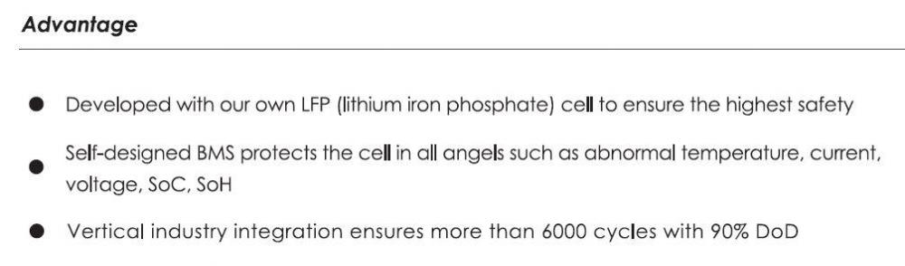

wolfandy Posted July 14, 2020 Share Posted July 14, 2020 Hi all I always remembered 80% usable capacity for the Pylon US3000 specs (2.8kWh) and their 6000 cycle life claim (this figure is also still listed on some online-shops). However, just having looked at the both the Pylon website as well as the manual of my latest Pylon (I unfortunately cannot find the manuals of my older ones...), both of them state 90% usable capacity (3.2kWh). Is my memory completely off or has the usable capacity changed at one point? Quote Link to comment Share on other sites More sharing options...
starmage Posted July 15, 2020 Share Posted July 15, 2020 As far as I am aware the BMS will shutdown at 10%SoC (state of charge) - hence 90% available for use. However the 6000 cycles is based on not going below 20%SoC. So the Us3000 is nominally 3.5kw but useable is 3,2kw.And if you want the >6000 cycles, dont drain the batteries below 20%SoC. If you do drain it regulalrly so that the BMS shutsdown, the rated cycles drop to something like 4500 ___ 1 Quote Link to comment Share on other sites More sharing options...
___ Posted July 15, 2020 Share Posted July 15, 2020 2 hours ago, starmage said: the BMS will shutdown at 10%SoC Not exactly. The BMS will ask the inverter to please stop discharging at 10% (if you have some sort of communication channel), but you can take it below 10%. I know, because when we test these things, we actually hack out the comms part and we take it right down to zero to see when the battery really switches off (so that it can be documented for support purposes). On a Victron system, the battery will indeed send DCL=0 (discharge current limit) at 10%, and this will cause it to stop discharging, or switch off if there is no grid. But in an emergency... you can use that last 10%. starmage 1 Quote Link to comment Share on other sites More sharing options...

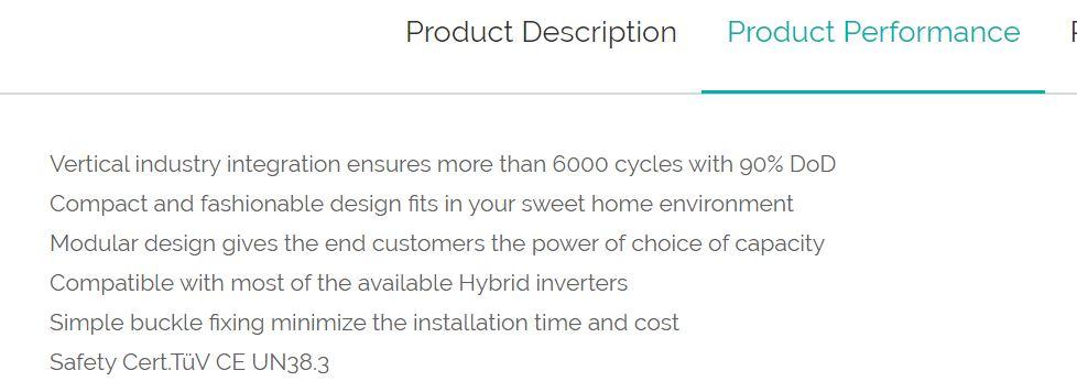

wolfandy Posted July 15, 2020 Author Share Posted July 15, 2020 Thanks @starmage and @plonkster 7 hours ago, starmage said: However the 6000 cycles is based on not going below 20%SoC. So the Us3000 is nominally 3.5kw but useable is 3,2kw.And if you want the >6000 cycles, dont drain the batteries below 20%SoC. This is also what I thought. But then both the Pylon website as well as the manual mention several times 'more than 6000 cycles with 90% DoD' - e.g. and and This made me question my assumption of not going below 20% DOD to achieve more than 6000 cycles. Any thoughts? Quote Link to comment Share on other sites More sharing options...
starmage Posted July 15, 2020 Share Posted July 15, 2020 lol and then you get the following product specs on their website (http://www.pylontech.com.cn/pro_detail.aspx?id=121&cid=23) - that only speaks to >4500 cyles. But even the worst numbers will give you more than 10years of daily cycle use. Personally mine is set to only discharge to 40% on daily use - the rest is left for possible loadshedding (Tshwane only have 2hr load shedding slots) Quote Link to comment Share on other sites More sharing options...
