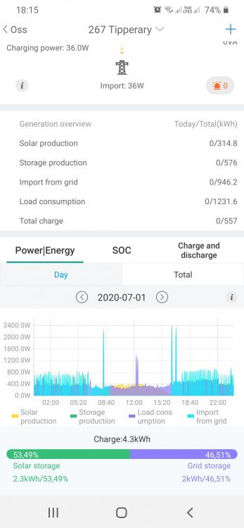

DieDusman Posted July 15, 2020 Share Posted July 15, 2020 Long story short, I have a 3kW Growatt Inverter, 2 x 200AH Lead Acid Gel batteries and 3 x 330W Canadian solar panels. The people who installed my system did not quite know what they were doing and this became evident when they procduced a COC without any labels or blanking plates on the DB boards. The settings on the inverter were mostly left defualt and I familirised myself with the various options. About 2 months in, I started to have issues where the inverter would switch between the utility power and battery every few minutes (only at night when the solar was not carrying the load), with the lights in the house flickering every time. I changed the 3rd option from APL to UPS to see if it makes a difference, but alas, it didn't. Every time it switched over, my pc would reboot, until I got fed up and got a seperate UPS for it. So last week I noticed that my solar charge during the day is hovering around 80W, down from the usual 500W+. Then load shedding started... Guess what, my power only lasts about 5 secs before the inverter shows 0V output, with the battery still at 26.0 V. Any ideas? Anyone willing to hazard a guess as to where I can start to poke? The supplier of the system has been promising to send soemone to check for the past two weeks, but I am not in the mood to be left in the dark until then. TIA. Screenshots of a normal day with the frequent switching, then another when it all went fubar. Quote Link to comment Share on other sites More sharing options...

DieDusman Posted July 15, 2020 Author Share Posted July 15, 2020 Problem is, the inverter refuses to carry any load for more than a second without the mains (was not always the case). When I view the data, it shows that the output is something like 1.6V @ 50hz Quote Link to comment Share on other sites More sharing options...
