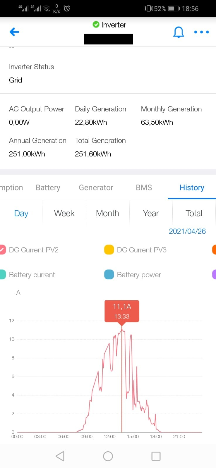

I'm deciding between the same but leaning towards the Solis RHI-6K 48ES-5G hybrid. The reason is the 9.9A limit on the 5kw Sunsynk per MPPT which is below that of the larger panels. Another option has popped up and that is the Sofar HYD 6000 ES. And then, a bit more expensive the Goodwe and the larger Sunsynk. Seems there are a lot of choices at the moment.
I'm leaning towards the Solis RHI though, Solis just looks legit and has a large international footprint.
Just check the battery specs for the Solis. I know some of their 5G models use HV batteries, which means you need at least 3 or 4 battery modules off the bat.
It looks like this issues has been fixed, I saw the following two screenshots from someone on the Sunsynk Whatsapp support group.
He was using JA Solar 455W panels (JAM72S20 455/MR series).
Link to post
Share on other sites
That’s great news. Was this after a firmware update? Pity there is no public change log or history that we can see what was done in each version.
