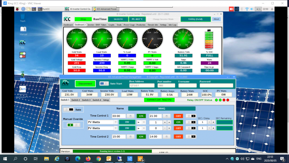

If you have a Pi running ICC you can definitely do it. Mannie has developed an app called APM which gets values from ICC see below, so you wire the geyser with 1 x 2CH sonoff swicth with 2 x relays 30amp (1 to grid AC and the other to inverter AC) and do the automation on APM. Done.
