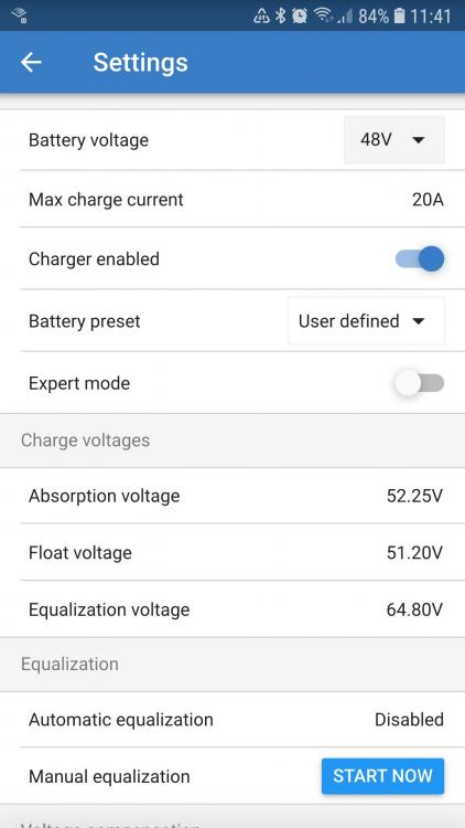

Louisvdw Posted August 17, 2020 Posted August 17, 2020 12 hours ago, Konrad said: DC Rebel Gen2 LiFePo4 210Ah batteries Those batteries does not have any communications from the specs I see on the website. If the battery does have comms that can talk the the Multiplus it does improve some aspects of the overall system, but that is not required. I don't have these batteries, but my batteries currently does not talk to the rest of the system. I also use the Multiplus in the ESS mode and it works perfectly. As your battery does not have communications, you will have to set the parameters for charge/discharge when you install the system. In an ESS these settings will come from the SmartSolar MPPT. Just connect to the MPPT using your phone and the VictronConnect App and make the changes in Settings -> Battery Max charge current = 70A (batteries can do 80, but your MPPT only 70) Battery preset = User defined (the Lithium battery options might be close, so you can try them as long as they are not larger than what your battery can do) Absorption = 56.8V Float = 54V Keep Equilization Disabled Here is my battery settings: And the specs for your batteries. You are doing 4S. Also when you set up the inverter settings in the Multiplus for ESS limit your inverter to 80A max. Quote

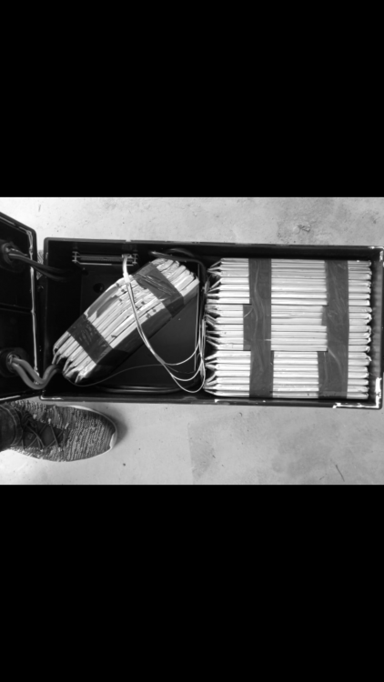

Gerlach Posted August 18, 2020 Posted August 18, 2020 Oohhhoooo @Konrad get your self ready for some headaches. I know of 4 setups with this batteries where it was a massive #$&@*#. And have seen with my own eyes. Local installer in capetown is using them in his installs. One of my friend friends, well 3 of them used this installer. The ine setup was 4s2p setup. Month later he pick up that something isn't lekker, so my friend pop in to go check. One was already charging over 18v , 2 bms units already blown and one under volts. The installes, same stories. This batteries act the same like lead acid batteries where need a ballancer unit lile HA02 between them to keep the batteries ballance because the battery next to the other battery don't no what is doing and all that sort of stuff. What can happend to is, the bms charge fits open on the one batterye, then all that charge will run to the other batteries over charging them, or the other don't even charge then. There was a massive fight on FB between a buyer and the brand name you posted because he had the same problem. Batteries only lasted a few weeks. Quote

Gerlach Posted August 18, 2020 Posted August 18, 2020 37 minutes ago, Konrad said: @Gerlach which inverters were used at your friends installs? @Konrad Growatt and Sunsynk. I added a pick to show how they look inside Quote

Louisvdw Posted August 18, 2020 Posted August 18, 2020 1 hour ago, Gerlach said: @Konrad, looking at these pictures of the inside, I would advise you to rather get a real battery instead. You can build a DIY battery like Gerlach and myself did (check out https://lithiumbatteriessa.co.za/ ) , or buy something like Pylontech, Dyness, Freedomwon that can talk to the Multiplus inverters. Quote
