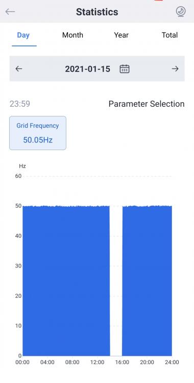

How would you measure / report on power fails / load shedding?
I can monitor "Grid side L1 power" (167) that reports correctly that there is a 0.00W supply. If however the PV panels supply more than needed this also goes to zero, really messing up automations as there is not a power failure but at a state that power from the grid is not needed.
How would you monitor power fail (i.e. no incomming power from grid) vs "no supply needed as there is enough" ?

Can you get the grid frequency? It drops during load shedding.

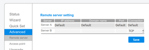

A fellow Sunsynk owner managed to log into the Sunsynk supplied WIFI logger.  I pasted his feedback posted on the Sunsynk forum below.  Would this assist in anyway for your custom monitoring project?  Does it indicate that one may be able to do away with having to use a Raspberry Pi to manage the data/transfer?
"Hi folks, somewhat related, I noticed the data logger listens on port 80/http, and has a web UI, and allows doing config for the data logger. First, it has default password of admin:admin.
Hehe, um, this is exactly why I have proper wifi setup with my IoT stuff on a seperate VLAN and wifi SSID. IoT things aren't that secure. Anyhow, noticed you can at least change the admin console HTTP password for it to something a little less guessable than admin:admin.
There does seem to be a feature to cater for 2 servers, so if we get to know what protocol to use, we could possibly setup our own data logging receiver server.
I am also stuck at this point, did you make progress beyond this? I am trying to get the data to mqtt or directly to my emoncms instance
