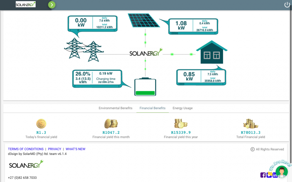

ROI is typically the single most important factor when considering going solar - even though being Loadshedding resilient and producing clean energy are close seconds and thirds.
The screenshot gives our savings on a 5.6kWp (320W modules) - 10KVA (Axpert inverters) - 13.5kWh (Solar MD Li-Ion Battery) for the past 3.5 years. Cost of system R200K. Annual solar savings: R25K+
What it doesn't show, is that we have further estimated savings of R25,000-R30,000 per year in avoided petrol purchases and vehicle maintenance as the system is also powering our Nissan Leaf EV. We use the electric vehicle for school runs, daily shopping and the odd meetings/outings and are able to have it on the solar powered plug for 3-4hours per day.
Standalone the solar system will pay for itself in 6-8 years but adding the car doubled the ROI of the solar system.
Quite impressive on just the standalone system by adding the vehicle charging it seems like improving the ROI-efficiency, that makes good sense.
