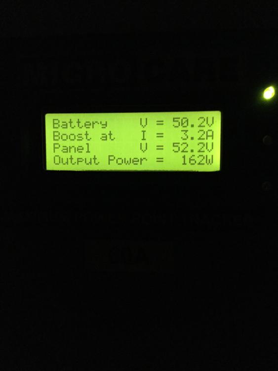

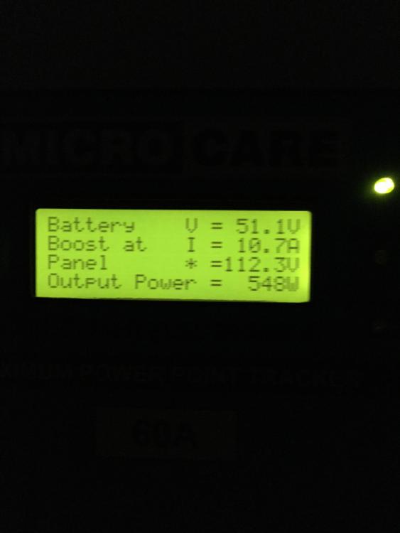

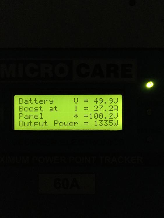

I took this pics this morning from 6:30 onward. Roughly every hour thereafter I took the next one..
6:30 the sun had just come up.
7:30
8:30
9:30
Then at 10am I had to go to town and couldn’t take more pics.  By 10:30 it was probably around 1500w to 1600w.
Never mind the battery voltage at 8:30, that was when the kettle was on.
What I am illustrating here is that this East facing array (6x330w) starts charging from quite early in the day. You want to avoid midday peaks as we are all limited to a certain number of watts. Rather keep that number lower for a longer time than have very high charge rate for 2 hours around midday.
