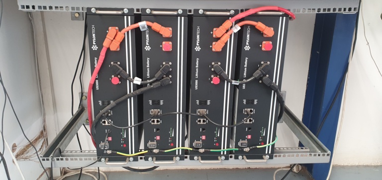

Cyon Posted November 12, 2020 Share Posted November 12, 2020 Hi, 3 hours ago, Furbz said: The battery cable was lengthened and probably not the same length that creates a volt drop. Reading this makes me want hit the wall. I can see that the battery cable is less that 2 meters. Quote Link to comment Share on other sites More sharing options...

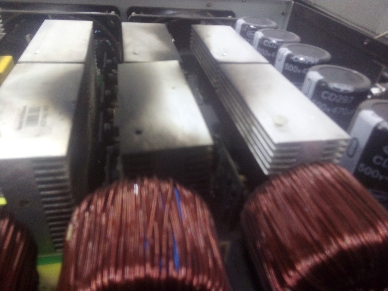

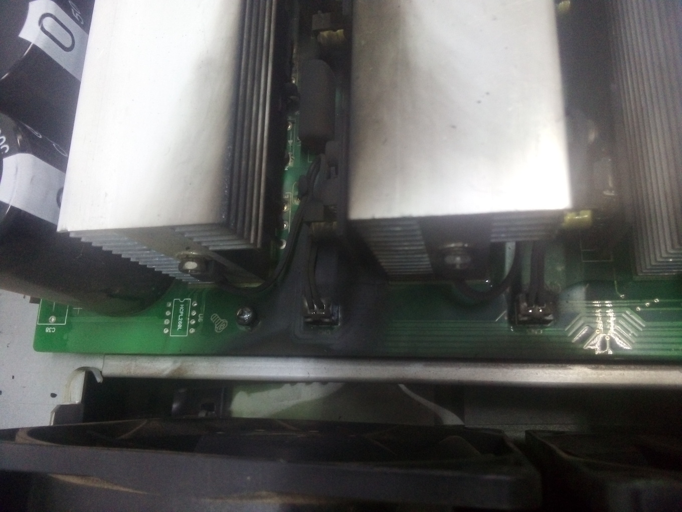

Furbz Posted November 13, 2020 Author Share Posted November 13, 2020 I am now getting sent a formal damage report stating that the damage is caused by a surge. i also believe that Mustek will be responding to this thread. nice to know they are willing to have an open discussion. my question is this, is there any way a surge could get past my AC surge arrestors and cause this type of damage? surely my arrestors would have popped to? based on the pictures of the unit it must have been an enormous surge. so i cannot understand how only the inverter failed. and nothing else in my offices failed (surge arrestors, computers, aircons, alarm, irrigation). Quote Link to comment Share on other sites More sharing options...
Furbz Posted November 13, 2020 Author Share Posted November 13, 2020 pictures of the unit damage Quote Link to comment Share on other sites More sharing options...
JustinSchoeman Posted November 13, 2020 Share Posted November 13, 2020 What are the chances of all three phases surging simultaneously? Do you have large 3 phase equipment? Personally, I would look at the common point for the 3 phases - the DC bus. And if it was a DC bus failure, then it is almost certainly a product fault. Quote Link to comment Share on other sites More sharing options...
Furbz Posted November 13, 2020 Author Share Posted November 13, 2020 (edited) 15 minutes ago, JustinSchoeman said: What are the chances of all three phases surging simultaneously? Do you have large 3 phase equipment? Personally, I would look at the common point for the 3 phases - the DC bus. And if it was a DC bus failure, then it is almost certainly a product fault. we do have an injection molder. it's not massive though. pulls around 2kw when on. this equipment IS NOT on the backup side so never pulls from the inverter at all. this equipment is also only run maybe twice a year and was not on when the inverter blew your second point: i'll have to get someone to look at that for me, i am not going to know what i am looking at without substantial help. maybe i can post pictures? the issue here is if i open the unit to look then that certainly voids the warranty. and i somehow doubt i'd get this info or pictures from Mustek. i have requested that Mustek include on their report how it is possible that nothing else blew at my offices and how this apparent surge got past my surge arrestors without them blowing up. i just do not see how only the inverter blew. it makes no sense. Edited November 13, 2020 by Furbz Quote Link to comment Share on other sites More sharing options...
JustinSchoeman Posted November 13, 2020 Share Posted November 13, 2020 10 minutes ago, Furbz said: your second point: i'll have to get someone to look at that for me, i am not going to know what i am looking at without substantial help. maybe i can post pictures? Unfortunately, it would be difficult to tell from pictures. It would need to go for a 3rd party evaluation if this goes to arbitration or a court case. I would challenge them to: 1) indicate exactly which requirements in the installation manual you violated, and 2) provide written proof, preferably from an independent 3rd party, that the failure was caused by an external power surge. Quote Link to comment Share on other sites More sharing options...
Cyon Posted November 13, 2020 Share Posted November 13, 2020 I think (Correct me is I'm wrong as I'm learning.) Did you had no power/load-shedding from Eskom, and when the power comeback the inverter pop? I think Eskom screwed up and drop the neutral and the voltage when up. Yes your inverter is suppose to handle it but been in for so many repairs the people didn't fix it 100% correctly? Send photos of the AC surge protecting units?> Quote Link to comment Share on other sites More sharing options...
Furbz Posted November 13, 2020 Author Share Posted November 13, 2020 9 minutes ago, JustinSchoeman said: Unfortunately, it would be difficult to tell from pictures. It would need to go for a 3rd party evaluation if this goes to arbitration or a court case. I would challenge them to: 1) indicate exactly which requirements in the installation manual you violated, and 2) provide written proof, preferably from an independent 3rd party, that the failure was caused by an external power surge. Thanks, i will certainly be taking this further if their report is not substantive. 1 minute ago, Barryv said: I think (Correct me is I'm wrong as I'm learning.) Did you had no power/load-shedding from Eskom, and when the power comeback the inverter pop? I think Eskom screwed up and drop the neutral and the voltage when up. Yes your inverter is suppose to handle it but been in for so many repairs the people didn't fix it 100% correctly? Send photos of the AC surge protecting units?> Hi, Nope it was business as usual. no load-shedding or power outage. surely if COJ did screw up and that did occur, my surge arrestors would have also blown? or at the least show damage? yeah thats my wonder, who is to say it was repaired correctly. the counterargument to this is it worked perfectly for a good number of months before it blew again. this is my AC surge arrestors. picture taken after the inverter blew on request of Mustek. Quote Link to comment Share on other sites More sharing options...
