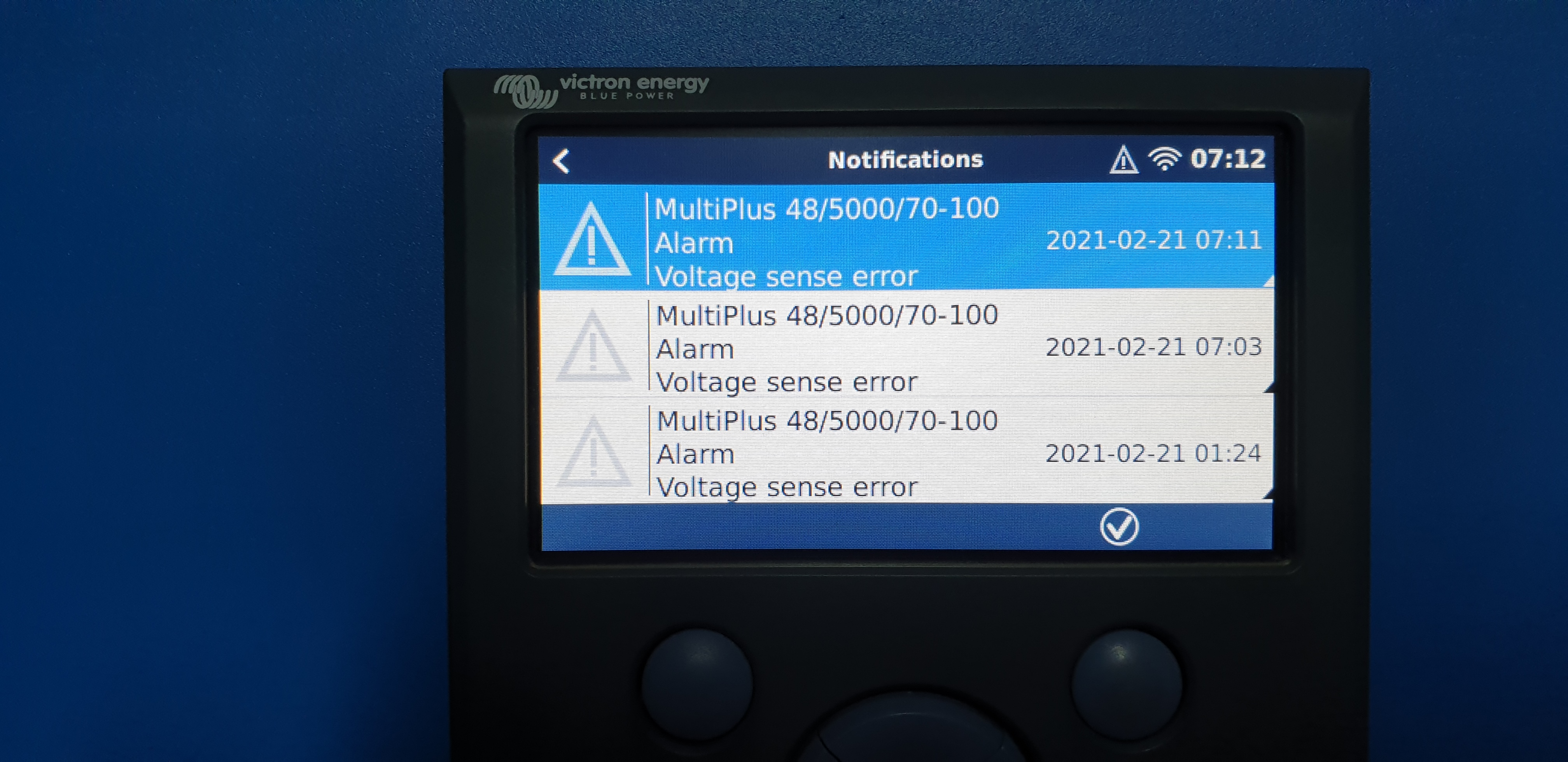

HennieJH Posted February 21, 2021 Author Share Posted February 21, 2021 So after being up and down, and getting the installer and battery supplier out to fault find problem, and still not able to get it solved, they are bazzled as they haven't seen this type of problem before. System Life: 16months old Problem Persistance: 14 months Quote Link to comment Share on other sites More sharing options...
HennieJH Posted February 21, 2021 Author Share Posted February 21, 2021 Why would battery voltage jump around so erratically? Unit has shut down completely. VideoEditor_20210221_091148_1_1_1_1.mp4 Quote Link to comment Share on other sites More sharing options...

Nicholas Posted May 11, 2021 Share Posted May 11, 2021 On 2021/02/21 at 9:20 PM, HennieJH said: Why would battery voltage jump around so erratically? Unit has shut down completely. VideoEditor_20210221_091148_1_1_1_1.mp4 This may be a result of the battery BMS engaging protection as a result of an out of bounds condition, such as a low or high cell. You will need to read the BMS directly in order to establish the specific nature of the problem. Quote Link to comment Share on other sites More sharing options...
