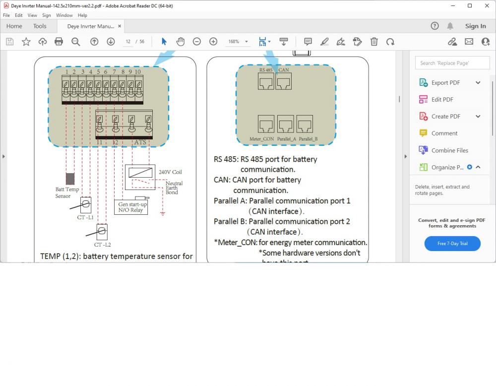

January 7, 20215 yr As I have researched I have discovered that the Deye neutral needs to be bonded to earth to prevent a floating neutral, when the inverter is off grid. The manual doesn't discuss the topic. Does anyone know if one of the auxiliary terminals can be used to drive a relay to earth the neutral? The auxiliary terminal is 1 -12. 1 and 2 are for the battery temperature probe and 3 and 4 are for the CT. I have searched and found no other information. Deye has as yet not replied to my query. Perhaps they are still on holiday. If someone can help it would be greatly appreciated.

January 20, 20224 yr Author Hi, yes the Deye can be used to drive a relay when the Inverter is on Island mode. You will have to contact them which contacts to use. Before I decided on Sunsynk I did send Deye China a request about which terminals to use but I received no feed-back.
January 20, 20224 yr Author A floating neutral happens when the Inverter switches to Island mode. There is no connection between the Grid Neutral and the Neutral when on Island mode. On Grid mode the neutral gets the reference from the earth back at the Eskom distribution box. Legally the neutral of the inverter output is not allowed to be bound to the Grid neutral. When on island mode the auxiliary output should drive a relay which connects the output neutral to an earth spike, when on island mode.

June 7, 20224 yr On 2022/01/20 at 7:03 PM, TonyH said: Hi, yes the Deye can be used to drive a relay when the Inverter is on Island mode. You will have to contact them which contacts to use. Before I decided on Sunsynk I did send Deye China a request about which terminals to use but I received no feed-back. Hello.. Did you get any feedback? I have a Deye 5kw and want to know where to do this..

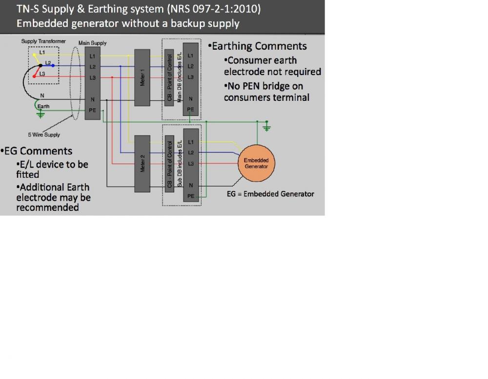

August 2, 20224 yr Author The new Deye manual shows where the ATS connection is. The ATS is where the connection is made to the Neutral /Earth bonding relay is made. Just a note of caution. You should have a good earth spike to bond the earth at your home. This protects the ESKOM earth if according to San regulations for a power generator. The older Deye manuals didn't show this ATS connection.
August 2, 20224 yr 3 minutes ago, TonyH said: The new Deye manual shows where the ATS connection is. The ATS is where the connection is made to the Neutral /Earth bonding relay is made. Just a note of caution. You should have a good earth spike to bond the earth at your home. This protects the ESKOM earth if according to San regulations for a power generator. The older Deye manuals didn't show this ATS connection. I was under the impression that all earth's should be common ? How would seperating them "protect " Eskoms earth?

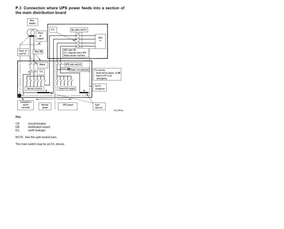

August 2, 20224 yr Author When the Inverter is on Island mode the ATS relay pulls the neutral down to earth. If the neutrals aren't separated it is possible to power the neutral back to ESKOM even when they have isolated from their side. This is dangerous for all who are connected to the ESKOM neutral. seen below:
August 2, 20224 yr 9 minutes ago, TonyH said: When the Inverter is on Island mode the ATS relay pulls the neutral down to earth. If the neutrals aren't separated it is possible to power the neutral back to ESKOM even when they have isolated from their side. This is dangerous for all who are connected to the ESKOM neutral. seen below: Ok but that would mean the system is not set up correctly as the neutrals always have to be separated ? If its not its going to be very unstable and have lots of nuisance tripping afaik. Also how would power be able to go back to Eskom if you are creating a earth /neutral bond even if you had a neutral from the non essentials side ? Edited August 2, 20224 yr by Nexuss
August 2, 20224 yr Author 7 minutes ago, Nexuss said: Ok but that would mean the system is not set up correctly as the neutrals always have to be separated ? If its not its going to be very unstable and have lots of nuisance tripping afaik. Also how would power be able to go back to Eskom if you are creating a earth /neutral bond even if you had a neutral from the non essentials side ? A lot of installers are not separating the Neutral of the UPS side or they are simply joining the neutral UPS to Neutral Eskom. This is illegal. If the installation is done according to the UPS diagram with a EL on the output of the Inverter there will be no nuisance trips, because the ATS relay only grounds the neutral when in island mode. The grid side of the inverter has a separate EL to the non essentials. For me that is only my Garage with a washing machine and a tumble dryer.
