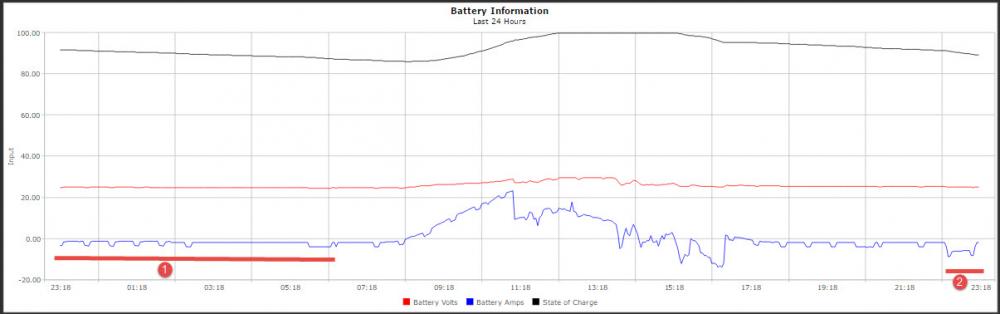

Guest Posted July 12, 2016 Share Posted July 12, 2016 Here is my load, mainly the fridge, with a bunch of small things off-grid. Stripe 1 is the Bosch and other loads, Stripe 2 is where I added the old freezer to test. At this rate it is going straight back onto Eskom, and up for sale soon. Quote Link to comment Share on other sites More sharing options...
