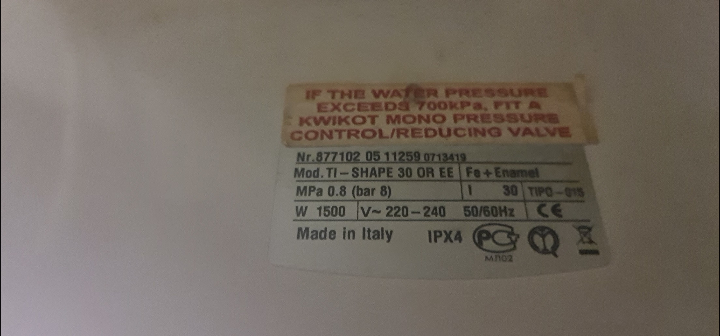

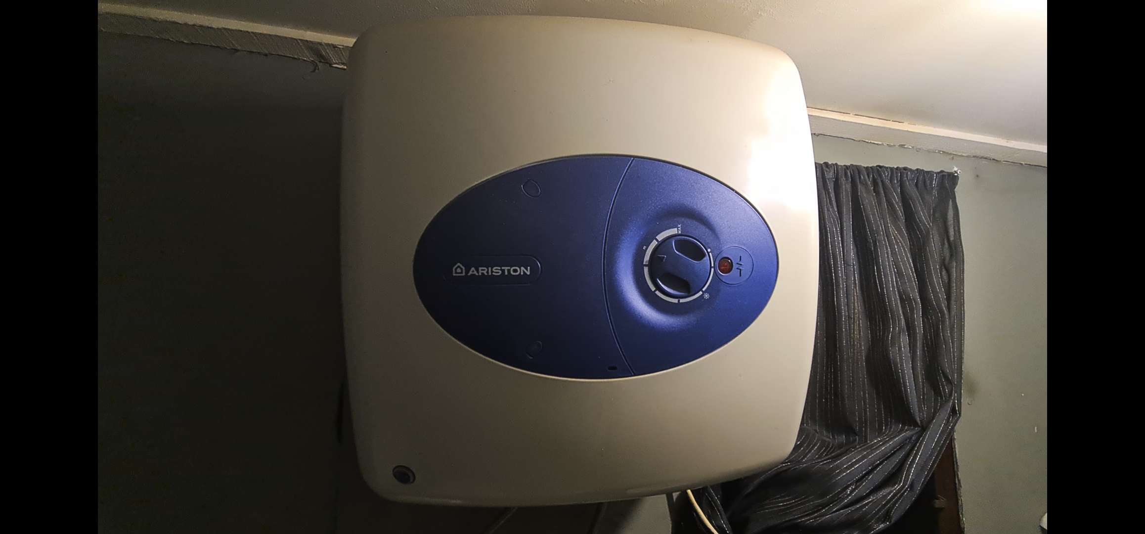

I also have a cottage I'm renting out thats running from my inverter. First thing I did before getting the tenants was to put in a gas stove and oven. They have a 30l under counter geyser for their shower and kitchen which seems to work fine instead of the on demand hot water systems. My daily usage including my tenants is 35kwh per day. I also installed a private prepaid meter for them so they are now much more aware of their electricity usage.
Cooking on gas works out better as you don't need to wait for a plate to get hot. Pots and pans are hot enough to cook fairly quickly instead of waiting for an electric stove to heat up so you also end up wasting less time and heat when cooking with gas.
