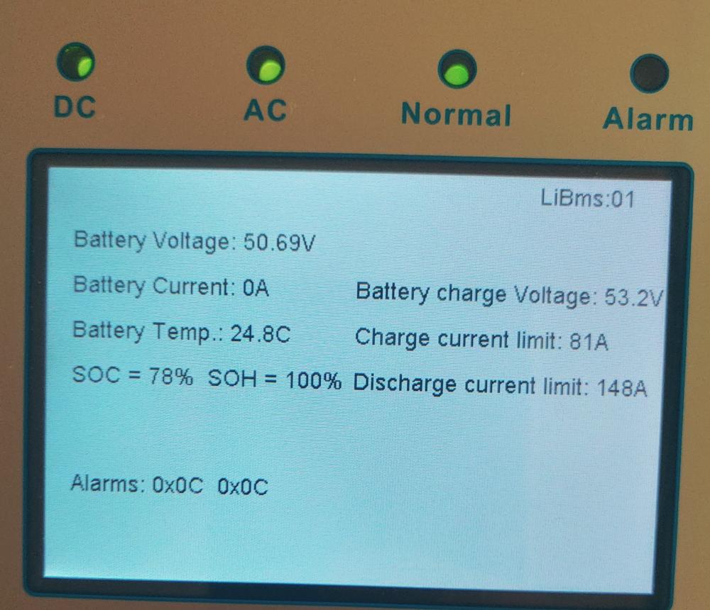

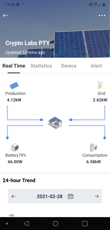

SOC at 78c, sunsynk 5.5KW inverter and 4x Pylontech US3000c
28 minutes ago, YellowTapemeasure said:
How long has it been sitting on 78%?
The Pylontechs usually sit for a long time at around 80%, and then quickly reach 95 and then 100%.
Most of the day. Its not taking any power. That is what is strange.
Two of the 4 shows 5 SOC leds while the other only flash the running led intermittently.
System is new. Turned on yesterday so I'm still getting to know it.
Thanks for the answer. I'm still not sure evething is all good,

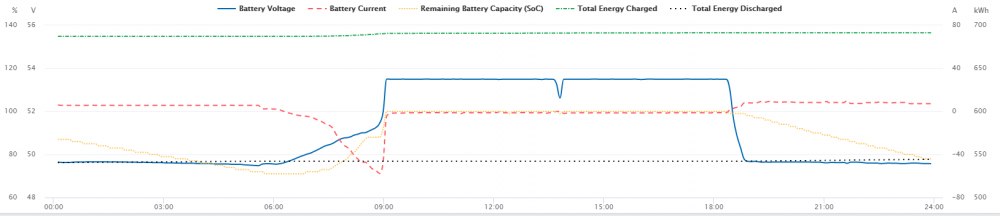

They usually hang at 89%, not 80%...
You are correct, here are mine, they plateau at 88%, but for @hannesz benefit, remember that this is in daily use since many months ago and considered normal behaviour:

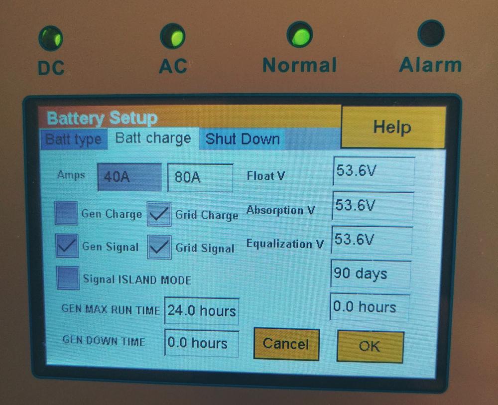

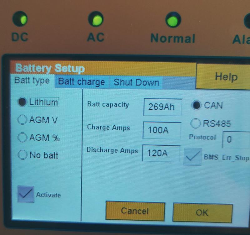

Just wanted to find out. When connecting the Pyontechs US3000c to the Sunsynk 5KW. I selected the lithium option under battery settings as well as CAN option and BMS_Err setting. All seems to work fine and also noticed the perceived pause at 89% when charging.
1. On the page where lithium is selected, at the bottom left what is the Activate checkbox for? mine is unchecked but still works fine.
2. Does it matter what the Float, absorption and equalisation are set to? Or does the BMS handle everything .
Even though i suspect it is not being used, mine is set to : Float: 51.8V
                                                                                        absorption: 52.5V
                                                                                         equalisation: 53V (I also understand that equalisation is more for lead acid type batteries)
Any ideas on the "Activate" checkbox below all the battery types.
As i said, mine is off but the batteries work and behave as expected.
